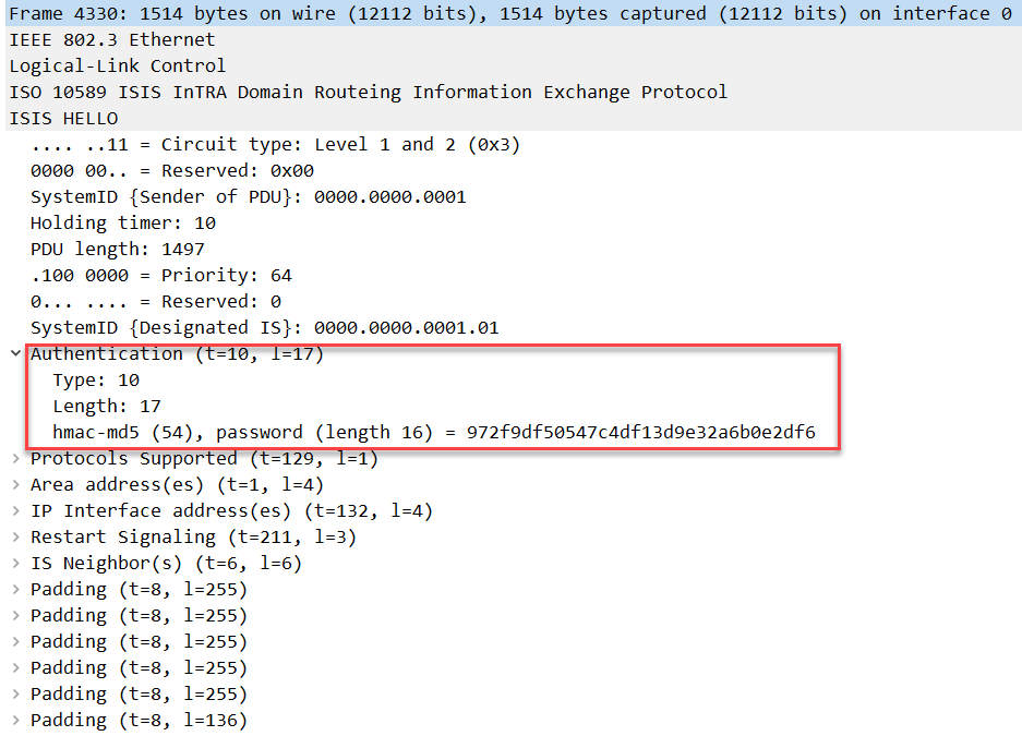

Once you configure this, only hello packets will be authenticated. Here’s a capture of an authenticated hello packet:
Frame 4330: 1514 bytes on wire (12112 bits), 1514 bytes captured (12112 bits) on interface 0
IEEE 802.3 Ethernet
Logical-Link Control
ISO 10589 ISIS InTRA Domain Routeing Information Exchange Protocol
ISIS HELLO
    .... ..11 = Circuit type: Level 1 and 2 (0x3)
    0000 00.. = Reserved: 0x00
    SystemID {Sender of PDU}: 0000.0000.0001
    Holding timer: 10
    PDU length: 1497
    .100 0000 = Priority: 64
    0... .... = Reserved: 0
    SystemID {Designated IS}: 0000.0000.0001.01
    Authentication (t=10, l=17)
        Type: 10
        Length: 17
        hmac-md5 (54), password (length 16) = 972f9df50547c4df13d9e32a6b0e2df6
    Protocols Supported (t=129, l=1)
    Area address(es) (t=1, l=4)
    IP Interface address(es) (t=132, l=4)
    Restart Signaling (t=211, l=3)
    IS Neighbor(s) (t=6, l=6)
    Padding (t=8, l=255)
    Padding (t=8, l=136)
Packet Capture: IS-IS HMAC MD5 Authentication Hello Packet

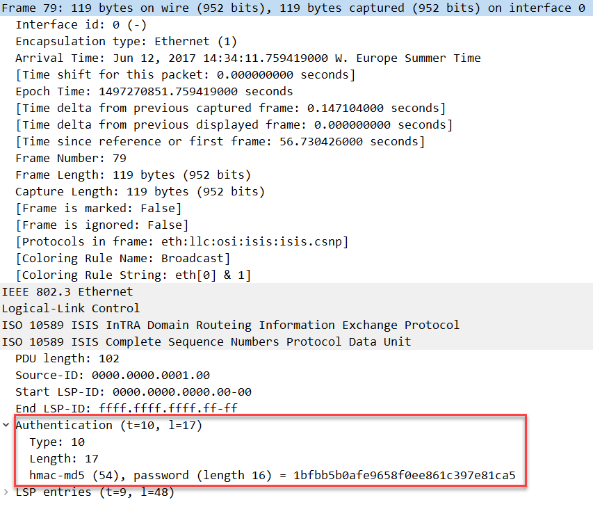

Instance Authentication
The second option is instance authentication. Here’s how to configure this:
R1(config)#router isis
R1(config-router)#authentication mode md5
R1(config-router)#authentication key-chain ISIS_AUTH
R2(config)#router isis
R2(config-router)#authentication mode md5
R2(config-router)#authentication key-chain ISIS_AUTH
The authentication key-chain command allows you to choose if you want to activate this for level 1, level 2 or both. If you don’t supply it as I did, then it will be applied to both levels.
Once you enable this, your LSPs and SNPs will be authenticated. Not your hello packets! Here’s an example of a CSNP that is now authenticated:
Frame 79: 119 bytes on wire (952 bits), 119 bytes captured (952 bits) on interface 0
    Interface id: 0 (-)
    Encapsulation type: Ethernet (1)
    Arrival Time: Jun 12, 2017 14:34:11.759419000 W. Europe Summer Time
    [Time shift for this packet: 0.000000000 seconds]
    Epoch Time: 1497270851.759419000 seconds
    [Time delta from previous captured frame: 0.147104000 seconds]
    [Time delta from previous displayed frame: 0.000000000 seconds]
    [Time since reference or first frame: 56.730426000 seconds]
    Frame Number: 79
    Frame Length: 119 bytes (952 bits)
    Capture Length: 119 bytes (952 bits)
    [Frame is marked: False]
    [Frame is ignored: False]
    [Protocols in frame: eth:llc:osi:isis:isis.csnp]
    [Coloring Rule Name: Broadcast]
    [Coloring Rule String: eth[0] & 1]
IEEE 802.3 Ethernet
ISO 10589 ISIS Complete Sequence Numbers Protocol Data Unit
    PDU length: 102
    Source-ID: 0000.0000.0001.00
    Start LSP-ID: 0000.0000.0000.00-00
    End LSP-ID: ffff.ffff.ffff.ff-ff
        Type: 10
        Length: 17
        hmac-md5 (54), password (length 16) = 1bfbb5b0afe9658f0ee861c397e81ca5
    LSP entries (t=9, l=48)
Packet Capture: IS-IS HMAC MD5 Authentication CSNP

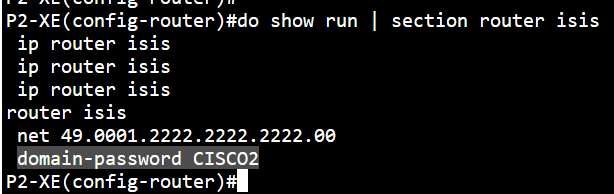

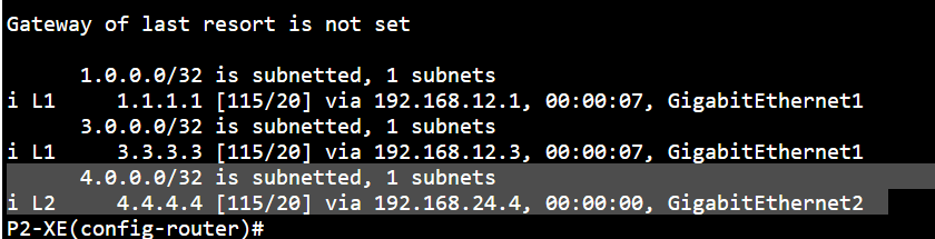

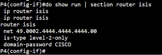

  4. Avatar for davidilles davidilles says:
    I need someone to help me confirm this.
    The passwords are mismatched yet P2 is still installing P4’s L2 routes which it shouldn’t…
    How is this possible? Is this a bug in CML?
    Hmm, that’s interesting. The only thing I can think of is that P2 is still installing P4’s Level-2 routes because IS-IS domain/area authentication does not affect Hellos. On some IOS XE/CML images, received LSPs are not strictly validated unless explicit validation is enforced, so mismatched passwords can still result in accepted L2 LSPs.
    This looks more like an image or platform-specific behavior rather than an IS-IS rule. If you want deterministic behavior where a mismatch blocks routing, use interface or Hello authentication or explicit LSP val
