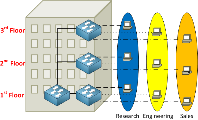

Switches with VLANs
When you work with switches, you must remember that there’s a big difference between physical and logical topology. Physical is just the way our cables are connected, while logical is how we have set up things ‘virtually’. In the example above, we have four switches, and I have created 3 VLANs called Research, Engineering, and Sales. A VLAN is a Virtual LAN, so it’s like having a “switch inside a switch”.
