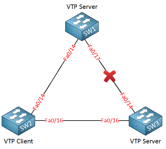

Let’s take a look at the configuration of VTP. I will be using three switches for this task. I erased the VLAN database and the startup configuration on all switches.
three vtp switches
