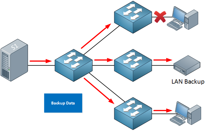

What kind of issues could this cause? Imagine we have a network with a LOT of hosts. Each time an interface goes up or down, a topology change notification will be generated, and ALL switches will set their aging time to 15 seconds. A host will trigger a topology change, and if you have a lot of hosts, you may end up with a network in a constant state of “topology changes”.
Here’s a situation that could occur:
