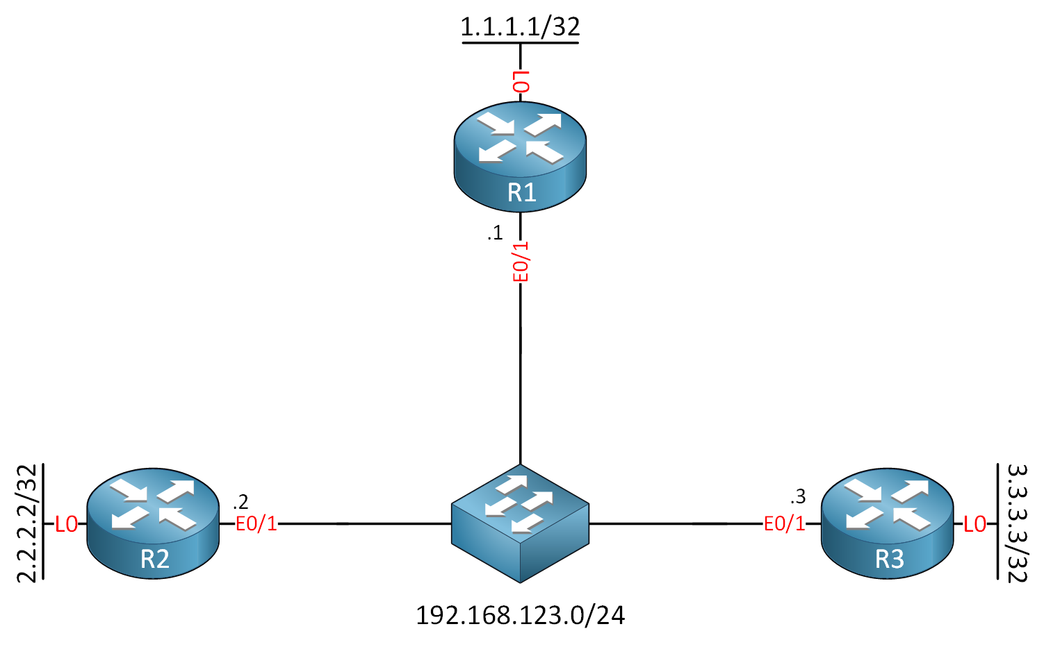

Here’s the topology we’ll use:
R1, R2 and R3 connected to a switch on 192.168.123.0/24, each with a loopback
I use an Ethernet switch in the middle because it’s the simplest way to demonstrate this. We don’t have to configure a WAN or tunnels. I’ll show the OSPF packets so you can see that it uses unicast packets. I use Cisco IOS Software [Dublin], Linux Software (X86_64BI_LINUX-ADVENTERPRISEK9-M), Version 17.12.1, RELEASE SOFTWARE (fc5) for this example.
