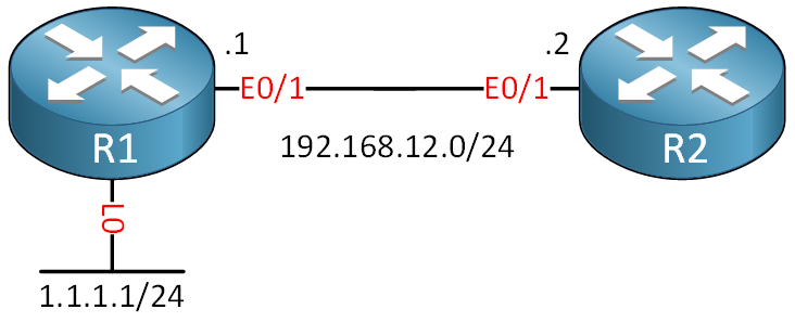

Here is the topology:
Two Routers R1 R2 One Loopback Interface
I’m using Cisco IOS Software [Dublin], Linux Software (X86_64BI_LINUX-ADVENTERPRISEK9-M), Version 17.12.1, RELEASE SOFTWARE (fc5) for these two routers.

Two routers are all we need. Let’s configure a loopback interface:
R1(config)#interface Loopback 0
R1(config-if)#ip address 1.1.1.1 255.255.255.0
Notice that I used a /24 subnet mask. We’ll see why this matters in a bit.
