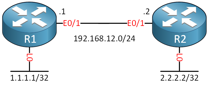

We will configure OSPF with a point-to-point network type over Ethernet. Here is the topology we’ll use:
Ospf Two Routers Two Loopback Interfaces
I use a direct Ethernet connection between the two routers to demonstrate this. This is common in scenarios where you have dedicated links between two routers and want to avoid DR/BDR elections on multi-access networks. I’ll show the OSPF packets so you can see it uses multicast hello packets. I use Cisco IOS Software [Dublin], Linux Software (X86_64BI_LINUX-ADVENTERPRISEK9-M), Version 17.12.1, RELEASE SOFTWARE (fc5) for this example.
