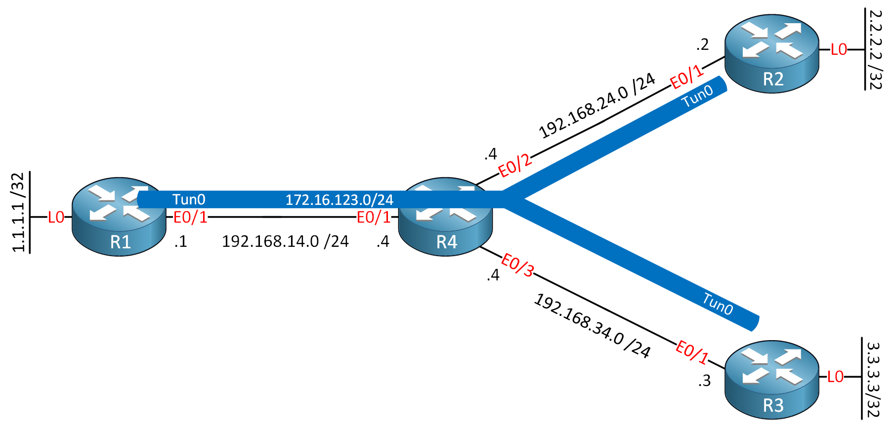

Here is the topology:
Four Routers Gre Multipoint Topology
We have four routers. R1 is the hub, and R2 and R3 are spoke routers. R4 sits in the middle to emulate a WAN. I use Cisco IOS Software [Dublin], Linux Software (X86_64BI_LINUX-ADVENTERPRISEK9-M), Version 17.12.1, RELEASE SOFTWARE (fc5) for this example.

Don’t worry about the tunnel configuration. It’s pre-configured and works out of the box. This way, you only have to focus on the OSPF configuration. Here’s what you need to know:
  • R1 uses Generic Routing Encapsulation (GRE) multipoint, which is a GRE tunnel that can connect to two or more spoke routers using a single interface.
  • This is a hub-and-spoke topology, so there is no direct communication between R2 and R3. All traffic goes through R1.
  • The tunnel is configured so that multicast traffic is possible.
