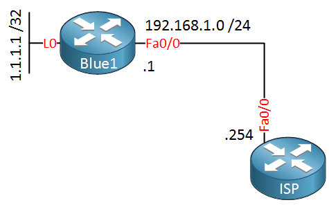

Blue1 with loopback 1.1.1.1/32 connected to the ISP router
Router Blue1 has a loopback interface with IP address 1.1.1.1 /32. Let’s create a static route on the ISP router so that we can reach it:
ISP(config)#ip route vrf Blue 1.1.1.1 255.255.255.255 192.168.1.1
We use the same ip route command but I specified to what VRF the static route belongs. Let’s see if this works:
ISP#ping vrf Blue 1.1.1.1
Sending 5, 100-byte ICMP Echos to 1.1.1.1, timeout is 2 seconds:
Success rate is 100 percent (5/5), round-trip min/avg/max = 8/24/52 ms

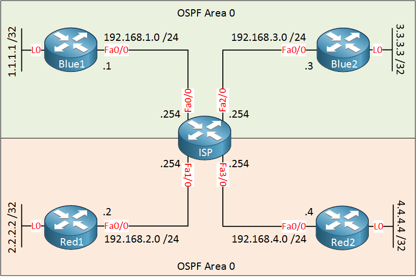

OSPF area 0 for customers Blue and Red on the ISP router with loopbacks
Customer “Blue” and “Red” both want to use OSPF to advertise their networks. Since we use VRFs, everything is separated. Let’s start with the OSPF configuration for customer Blue:
Blue1(config)#router ospf 1
Blue1(config-router)#network 192.168.1.0 0.0.0.255 area 0
Blue1(config-router)#network 1.1.1.1 0.0.0.0 area 0
Blue2(config)#router ospf 1
Blue2(config-router)#network 192.168.3.0 0.0.0.255 area 0
Blue2(config-router)#network 3.3.3.3 0.0.0.0 area 0
The OSPF configuration for the customer routers is pretty straight-forward. On the ISP router, we’ll have to specify what VRF we want to use:
ISP(config)#router ospf 1 vrf Blue
ISP(config-router)#network 192.168.1.0 0.0.0.255 area 0
ISP(config-router)#network 192.168.3.0 0.0.0.255 area 0
We configure OSPF process 1 and specify the VRF that we want to use, that’s all there is to it. Let’s do the same for customer Red:
Red1(config)#router ospf 1
Red1(config-router)#network 192.168.2.0 0.0.0.255 area 0
Red1(config-router)#network 2.2.2.2 0.0.0.0 area 0
Red2(config)#router ospf 1
Red2(config-router)#network 192.168.4.0 0.0.0.255 area 0
Red2(config-router)#network 4.4.4.4 0.0.0.0 area 0
ISP(config)#router ospf 2 vrf Red
ISP(config-router)#network 192.168.2.0 0.0.0.255 area 0
ISP(config-router)#network 192.168.4.0 0.0.0.255 area 0
The configuration is similar, I had to use another process ID on the ISP router since the first one is used for customer Blue. Here’s what the VRF routing tables on the ISP router look like now:
ISP#show ip route vrf Blue ospf
Routing Table: Blue
O       1.1.1.1 [110/2] via 192.168.1.1, 00:00:24, FastEthernet0/0
O       3.3.3.3 [110/2] via 192.168.3.3, 00:00:24, FastEthernet2/0
ISP#show ip route vrf Red ospf
Routing Table: Red
     2.0.0.0/32 is subnetted, 1 subnets
O       2.2.2.2 [110/2] via 192.168.2.2, 00:00:19, FastEthernet1/0
     4.0.0.0/32 is subnetted, 1 subnets
O       4.4.4.4 [110/2] via 192.168.4.4, 00:00:19, FastEthernet3/0
Two separate routing tables with the prefixes from each VRF, this is looking good.
