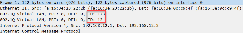

Above you see two routers called R1 and R2, imagine these routers are the customer sites that we want to connect through the service provider network which consists of SW1, SW2, and SW3. Our customer wants to use VLAN 12 between the two sites and expects our service provider to transport this from one site to another.
In my example, our customer will be using VLAN 12 for traffic between their sites. The service provider has decided to use VLAN 123 to transport everything for this customer. Basically, this is what will happen when we send frames between R1 and R2:
Cisco Q In Q Lab Vlan Tags
Whenever R1 sends traffic it will tag its frames for VLAN 12. Once it arrives at the service provider, SW1 will add an additional VLAN tag (123).  Once SW2 forwards the frame towards R2, it will remove the second VLAN tag and forwards the original tagged frame from R1.

Everything is now in place. Let’s do a quick test to see if R1 and R2 can reach each other:
R1#ping 192.168.12.2
Success rate is 100 percent (5/5), round-trip min/avg/max = 1/2/4 ms

As you can see above, the only VLAN that is active (besides VLAN 1) on these trunk links is VLAN 123. You won’t see VLAN 12 here because that’s the customer traffic and it’s encapsulated with VLAN 123. Another good way to prove this is by looking at spanning tree:

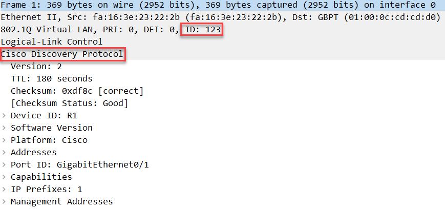

If you want, it can tunnel CDP, VTP, STP, and even point-to-point protocols like PAgP or LACP (Etherchannel). Let me show you what happens when you tunnel CDP traffic:
SW1(config)#interface fastEthernet 0/1
SW1(config-if)#l2protocol-tunnel cdp
SW2(config)#interface fastEthernet 0/2
SW2(config-if)#l2protocol-tunnel cdp
I’ll tell SW1 and SW2 to tunnel all CDP traffic between the interfaces that are connected to R1 and R2. Take a look below for the result:

By tunneling CDP packets between R1 and R2, they see each other as directly connected. That’s a great example of a “transparent” network. Here’s what it looks like in wireshark:
Frame 2: Packet, 369 bytes on wire (2952 bits), 369 bytes captured (2952 bits) on interface -, id 0
Ethernet II, Src: fa:16:3e:0c:c9:4f (fa:16:3e:0c:c9:4f), Dst: GBPT (01:00:0c:cd:cd:d0)
802.1Q Virtual LAN, PRI: 0, DEI: 0, ID: 123
Logical-Link Control
Cisco Discovery Protocol
    Version: 2
    TTL: 180 seconds
    Checksum: 0xde8a [correct]
    [Checksum Status: Good]
    Device ID: R2
    Software Version
    Platform: Cisco
    Addresses
    Port ID: GigabitEthernet0/1
    Capabilities
    IP Prefixes: 1
    Management Addresses
Packet Capture: 802.1Q Tunneling CDP
