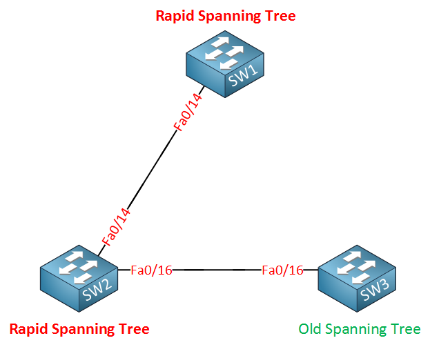

  • RSTP is backward compatible with classic STP, but falls back to slower convergence on links that connect to classic STP switches

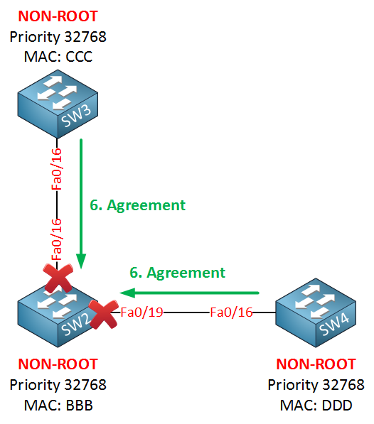

The exact same sync mechanism will take place now on these interfaces. SW2 will send a proposal on its fa0/16 and fa0/19 interfaces to SW3 and SW4. SW3 and SW4 will send an agreement:
rapid spanning tree agreement two switches
SW3 and SW4 don’t have any other interfaces, so they will send an agreement back to SW2:

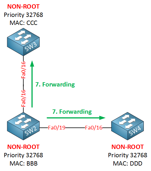

rapid spanning tree forwarding two switches
SW2 will place its fa0/16 and fa0/19 interface in forwarding, and we are done. This sync mechanism is just a couple of messages flying back and forth and very fast. It’s much faster than the timer-based mechanism of the classic spanning tree!

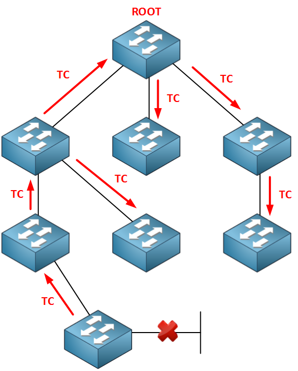

We don’t need this anymore because the topology change mechanism for rapid spanning tree is different. So, what’s different about the topology change mechanism?
With the classic spanning tree, a link failure would trigger a topology change. Using rapid spanning tree, a link failure is not considered as a topology change. Only non-edge interfaces (leading to other switches) that move to the forwarding state are considered as a topology change. Once a switch detects a topology change, this will happen:
  • It will start a topology change while timer with a value that is twice the hello time. This will be done for all non-edge designated and root ports.
  • It will flush the MAC addresses that are learned on these ports.
  • As long as the topology changes while the timer is active, it will set the topology change bit on BPDUs that are sent out these ports. BPDUs will also be sent out of its root port.
When a neighbor switch receives this BPDU with the topology change bit set, this will happen:
  • It will clear all its MAC addresses on all interfaces except the one where it received the BPDU with the topology change.
  • It will start a topology change while timer itself and send BPDUs on all designated ports and the root port, setting the topology change bit.
Rapid Spanning Tree TCN Flooding
Instead of sending a topology change all the way up to the root bridge as the classic spanning tree does, the topology change is now quickly flooded throughout the network. If you want to know exactly how this topology change mechanism works, then take a look at this lesson.
