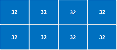

We start with our block of “256” but now we are playing with the third octet:
Block of 256 addresses
If we chop “256” into 8 blocks we get blocks with a size of “32”:
Block of 256 cut into eight blocks of 32
Let’s write down the first four subnets and their network addresses:
  • Subnet 1:
    • network address: 172.16.0.0
  • Subnet 2:
    • network address: 172.16.32.0
  • Subnet 3:
    • network address: 172.16.64.0
  • Subnet 4:
    • network address: 172.16.96.0
Let’s write down the broadcast addresses, remember this is the last address within the subnet:
  • Subnet 1:
    • broadcast address: 172.16.31.255
  • Subnet 2:
    • broadcast address: 172.16.63.255
  • Subnet 3:
    • broadcast address: 172.16.95.255
  • Subnet 4:
    • broadcast address: 172.16.127.255
What will the subnet mask be?
256 – block size = subnet mask
256 – 32 = 224
So the subnet mask will be 255.255.224.0. Keep in mind we are working with the third octet here.
