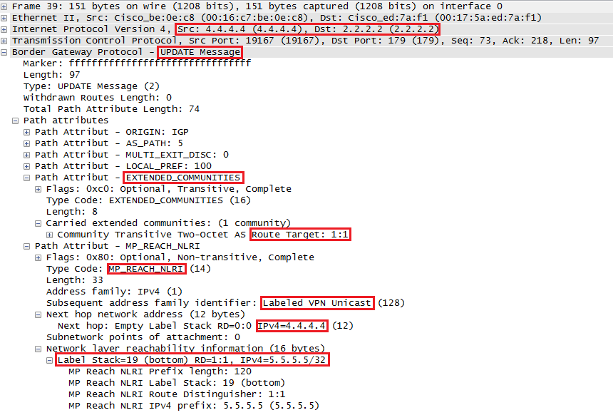

I figured it might be interesting to show you some wireshark captures of the things we discussed above. The first example is a BGP update where PE2 advertises the VPNv4 route for 5.5.5.5 /32 to PE1:
Frame 39: 151 bytes on wire (1208 bits), 151 bytes captured (1208 bits) on interface 0
Ethernet II, Src: Cisco_be:0e:c8 (00:16:c7:be:0e:c8), Dst: Cisco_ed:7a:f1 (00:17:5a:ed:7a:f1)
Internet Protocol version 4, Src: 4.4.4.4 (4.4.4.4), Dst: 2.2.2.2 (2.2.2.2)
Transmission Control Protocol, Src Port: 19167 (19167), Dst Port: 179 (179), Seq: 73, Ack: 218, Len: 97
Border Gateway Protocol - UPDATE Message
    Marker: ffffffffffffffffffffffffffffffff
    Length: 97
    Type: UPDATE Message (2)
    Withdrawn Routes Length: 0
    Total Path Attribute Length: 74
    Path attributes
        Path Attribut - ORIGIN: IGP
        Path Attribut - AS_PATH: 5
        Path Attribut - MULTI_EXIT_DISC: 0
        Path Attribut - LOCAL_PREF: 100
        Path Attribut - EXTENDED_COMMUNITIES
            Flags: 0xc0: Optional, Transitive, Complete
            Type Code: EXTENDED_COMMUNITIES (16)
            Length: 8
            Carried extended communities: (1 community)
                Community Transitive Two-octet AS Route Target: 1:1
        Path Attribut - MP_REACH_NLRI
            Flags: 0x80: Optional, Non-transitive, Complete
            Type Code: MP_REACH_NLRI (14)
            Length: 33
            Address family: IPv4 (1)
            Subsequent address family identifier: Labeled VPN Unicast (128)
        Next hop network address (12 bytes)
            Next hop: Empty Label Stack RD=0:0 IPv4=4.4.4.4 (12)
            Subnetwork points of attachment: 0
        Network layer reachability information (16 bytes)
            Label stack=19 (bottom) RD=1:1, IPv4=5.5.5.5/32
                MP Reach NLRI Prefix length: 120
                MP Reach NLRI Label Stack: 19 (bottom)
                MP Reach NLRI Route Distinguisher: 1:1
                MP Reach NLRI IPv4 prefix: 5.5.5.5 (5.5.5.5)
Above you can see quite some interesting items:
  • In the extended communities you can find the route-target value 1:1
  • In the NLRI information we find:
    • The VPNv4 address-family.
    • The next hop address 4.4.4.4.
    • The VPN label value 19.
    • The VPNv4 route:
      • RD 1:1
      • Prefix 5.5.5.5 /32

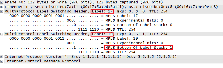

The second capture will show you what the packet from 1.1.1.1 to 5.5.5.5 looks like when we receive it on the P router:
Frame 40: 122 bytes on wire (976 bits), 122 bytes captured (976 bits)
Ethernet II, Src: Cisco_ed:7a:f1 (00:17:5a:ed:7a:f1), Dst: Cisco_be:0e:c8 (00:16:c7:be:0e:c8)
MultiProtocol Label Switching Header, Label: 17, Exp: 0, S: 0, TTL: 254
    0000 0000 0000 0001 0001 .... .... .... = MPLS Label: 17
    .... .... .... .... .... 000. .... .... = MPLS Experimental Bits: 0
    .... .... .... .... .... ...0 .... .... = MPLS Bottom Of Label Stack: 0
    .... .... .... .... .... .... 1111 1110 = MPLS TTL: 254
MultiProtocol Label Switching Header, Label: 19, Exp: 0, S: 1, TTL: 254
    0000 0000 0000 0001 0011 .... .... .... = MPLS Label: 19
    .... .... .... .... .... ...1 .... .... = MPLS Bottom Of Label Stack: 1
Internet Protocol version 4, Src: 1.1.1.1 (1.1.1.1), Dst: 5.5.5.5 (5.5.5.5)
Internet Control Message Protocol
Above you see the ICMP request from CE1 to CE2, the first label is the transport label (17) and the second label is the VPN label which has the bottom of label stack bit set.
