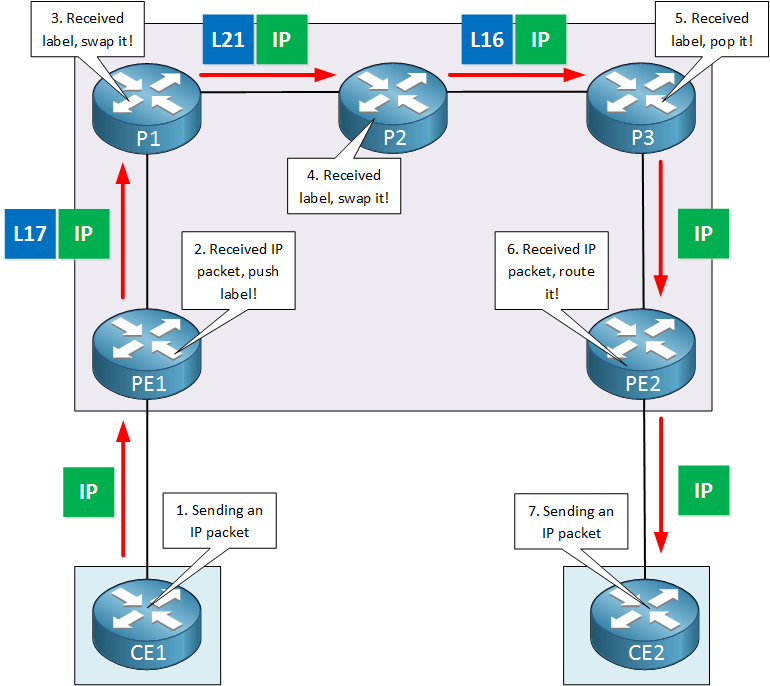

Let’s look at an example of how labels are pushed, swapped and popped in a MPLS network:
Mpls Routers Device Label Operations
Let me add some more detail to the picture above:
