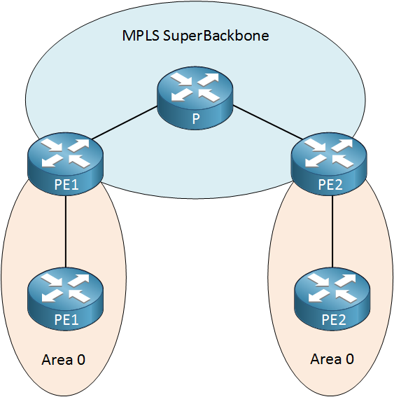

OSPF works a bit different when we use it as the PE-CE routing protocol, I’ll give you the short version here but if you want to know all details you can check RFC 4577.
Both of our customer sites are using OSPF area 0, normally it’s impossible to have two backbone areas unless you connect them to each other with a virtual link. When we use MPLS L3 VPN, the service provider network is seen by OSPF as the superbackbone:
Mpls Ospf Super Backbone Topology
This allows us to use area 0 on multiple sites without using virtual links, the superbackbone connects everything together. If you look on the CE routers you can see that they see the PE routers as ABR routers:

Above you can see that 192.168.12.2 (PE1) and 192.168.45.4 (PE2) are seen as ABR routers by the CE routers. The other question we still have to answer is how do the PE routers know to which area a prefix belongs and which LSA type to use when we redistribute a VPNv4 route back into OSPF for the customer?
Our PE routers need something to tell other PE routers which area and LSA type to use. We use two additional BGP extended communities for this:

Above you can see the OSPF domain ID which is exactly the same on both routers since I used the same OSPF process ID (2). The route type can be read like this:
  • Area: 0.0.0.0
  • LSA Type: 2
  • Options: 0
Don’t confuse the RT (route target) with the OSPF RT (route type). They use the same two letters which makes it easy to confuse the two…
When the PE router redistributes a VPNv4 route into OSPF, it will check the domain ID and route type.
When the domain ID is the same then a LSA type 1, 2 or 3 will be redistributed as a LSA type 3. LSA type 5 or 7 will always remain the same.
If the domain ID is different then LSA type 1, 2 or 3 will always be redistributed as external prefixes. Let’s see if this is true…I can easily test this by changing the OSPF process ID on one of the PE routers since this will change the domain ID:

Instead of O IA entries you now see O E2 entries. You can see that the domain ID has changed below:
