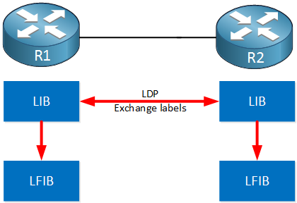

Two routers that have formed a LDP neighbor adjacency will exchange the label information in their LIBs to tell each other what label values to use for different prefixes.
R1 and R2 exchange labels with LDP between their LIBs, and each LIB builds an LFIB
All routers running LDP will now know what label values to use when they switch a MPLS packet to their neighbor.

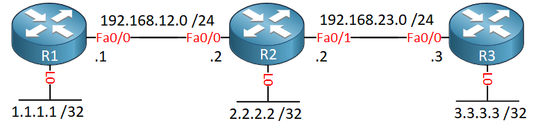

I will use the following three routers to demonstrate LDP:
R1, R2 and R3 connected in a row, each with a loopback
Each router has a loopback interface that we will use for the LDP neighbor adjacency. LDP will select the IP addresses on the loopback interfaces as the LSR IDs and the transport addresses. We also need the information in the RIB to build the LIB so I’ll configure OSPF to advertise all prefixes.

R2#show ip route
O        1.1.1.1 [110/2] via 192.168.12.1, 00:44:37, FastEthernet0/0
      2.0.0.0/32 is subnetted, 1 subnets
C        2.2.2.2 is directly connected, Loopback0
O        3.3.3.3 [110/2] via 192.168.23.3, 02:55:40, FastEthernet0/1
C        192.168.12.0/24 is directly connected, FastEthernet0/0
L        192.168.12.2/32 is directly connected, FastEthernet0/0
      192.168.23.0/24 is variably subnetted, 2 subnets, 2 masks
C        192.168.23.0/24 is directly connected, FastEthernet0/1
L        192.168.23.2/32 is directly connected, FastEthernet0/1
R2#show mpls ldp bindings
  lib entry: 1.1.1.1/32, rev 8
	local binding:  label: 200
	remote binding: lsr: 3.3.3.3:0, label: 301
	remote binding: lsr: 1.1.1.1:0, label: imp-null
  lib entry: 2.2.2.2/32, rev 6
	local binding:  label: imp-null
	remote binding: lsr: 3.3.3.3:0, label: 300
	remote binding: lsr: 1.1.1.1:0, label: 100
  lib entry: 3.3.3.3/32, rev 10
	local binding:  label: 201
	remote binding: lsr: 3.3.3.3:0, label: imp-null
	remote binding: lsr: 1.1.1.1:0, label: 102
  lib entry: 192.168.12.0/24, rev 2
	remote binding: lsr: 3.3.3.3:0, label: 302
  lib entry: 192.168.23.0/24, rev 4
	remote binding: lsr: 1.1.1.1:0, label: 101
R2#show mpls forwarding-table
Local      Outgoing   Prefix           Bytes Label   Outgoing   Next Hop
Label      Label      or Tunnel Id     Switched      interface
200        Pop Label  1.1.1.1/32       0             Fa0/0      192.168.12.1
201        Pop Label  3.3.3.3/32       126           Fa0/1      192.168.23.3
And here’s R3:
R3#show ip route
O        1.1.1.1 [110/3] via 192.168.23.2, 00:45:50, FastEthernet0/0
O        2.2.2.2 [110/2] via 192.168.23.2, 02:57:05, FastEthernet0/0
C        3.3.3.3 is directly connected, Loopback0
O     192.168.12.0/24 [110/2] via 192.168.23.2, 00:45:50, FastEthernet0/0
C        192.168.23.0/24 is directly connected, FastEthernet0/0
L        192.168.23.3/32 is directly connected, FastEthernet0/0
R3#show mpls ldp bindings
  lib entry: 1.1.1.1/32, rev 10
	local binding:  label: 301
	remote binding: lsr: 2.2.2.2:0, label: 200
  lib entry: 2.2.2.2/32, rev 8
	local binding:  label: 300
	remote binding: lsr: 2.2.2.2:0, label: imp-null
  lib entry: 3.3.3.3/32, rev 6
	remote binding: lsr: 2.2.2.2:0, label: 201
  lib entry: 192.168.12.0/24, rev 12
	local binding:  label: 302
  lib entry: 192.168.23.0/24, rev 2
R3#show mpls forwarding-table
300        Pop Label  2.2.2.2/32       0             Fa0/0      192.168.23.2
301        200        1.1.1.1/32       0             Fa0/0      192.168.23.2
302        Pop Label  192.168.12.0/24  0             Fa0/0      192.168.23.2
