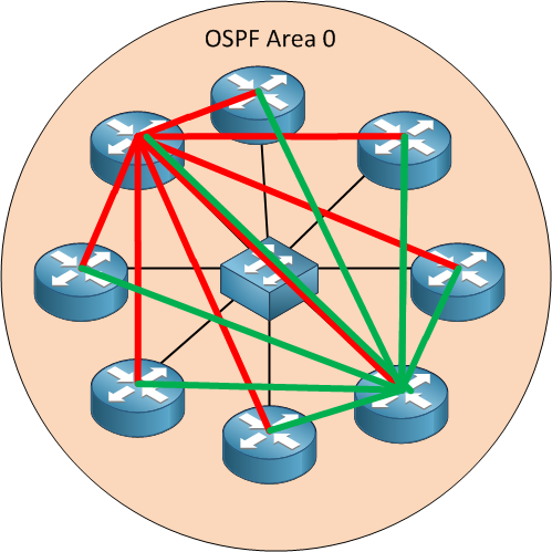

OSPF Designated Router
What if all our OSPF routers would just send their stuff to a single OSPF router who will then forward it to all the other OSPF routers? All our OSPF routers will know about all the routing information out there, but we will have far less OSPF traffic. OSPF uses something called a DR (Designated Router). All our OSPF routers will only form a “full” neighbor adjacency with the DR and not with all the other routers.
OSPF Backup Designated Router
Since bad stuff can happen to our networks, we want to have a backup for our DR. If it crashes, the BDR (Backup Designated Router) will take over. All our OSPF routers will only form full neighbor adjacencies with the DR and BDR and not with all other routers. This sounds efficient, right?

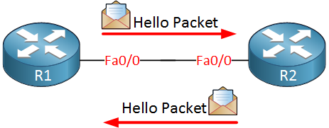

OSPF works differently than RIP or EIGRP, first of all, it’s a link-state compared to a distance vector (RIP), but it also doesn’t just send the link-state advertisements around. Routers have to become neighbors first. Once we have become neighbors, we are going to exchange link-state advertisements.
Once you configure OSPF, your router will start sending hello packets. If you also receive hello packets from the other router, you will become neighbors.

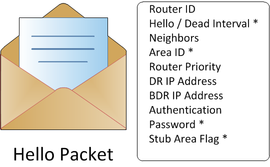

There’s one catch, however, there are a couple of fields in the hello packet, and many of them have to match otherwise, you won’t become neighbors. Let’s walk through the items in the hello packet and see what they are about:
  • Router ID: Each OSPF router needs to have a unique ID which is the highest IP address on any active interface. More about this later.
  • Hello / Dead Interval: Every X seconds, we will send a hello packet. If we don’t hear any hello packets from our network for X seconds, we declare you “dead,” and we are no longer neighbors. These values have to match on both sides to become neighbors.
  • Neighbors: All other routers who are your neighbors are specified in the hello packet.
  • Area ID: This is the area you are in. This value has to match on both sides to become neighbors.
  • Router Priority: This value is used to determine who will become designated or backup designated routers.
  • DR and BDR IP address: Designated and Backup Designated router.
  • Authentication password: You can use clear text and MD5 authentication for OSPF, meaning every packet will be authenticated. Obviously, you need the same password on both routers in order to make things work.
  • Stub area flag: Besides area numbers, OSPF has different area types. Both routers have to agree on the area type to become neighbors.OSPF Loopback Interface

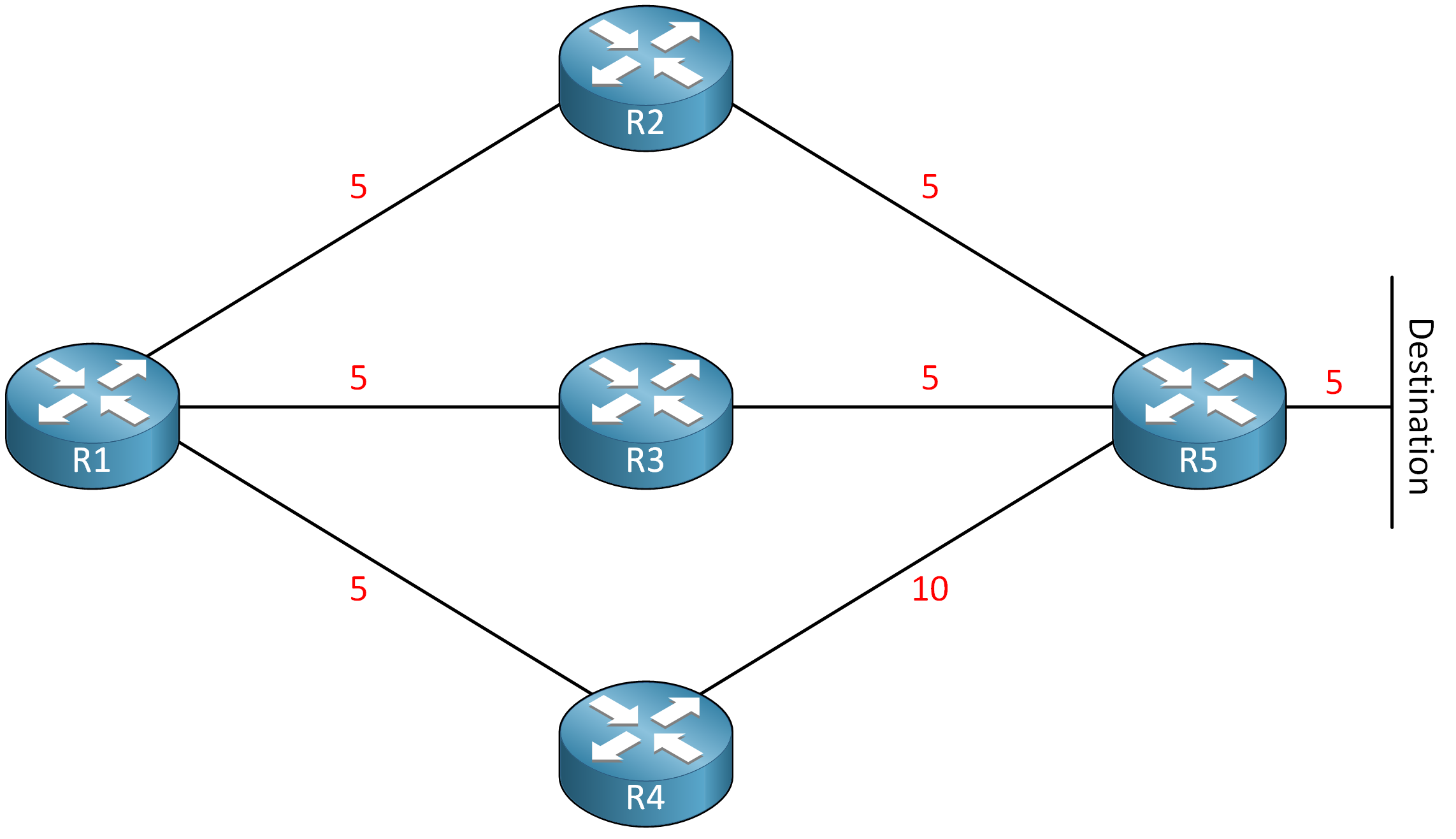

Look at the picture below, we are looking at R1 and running the SPF algorithm looking for the shortest path to our destination. Which one are we going to use?
