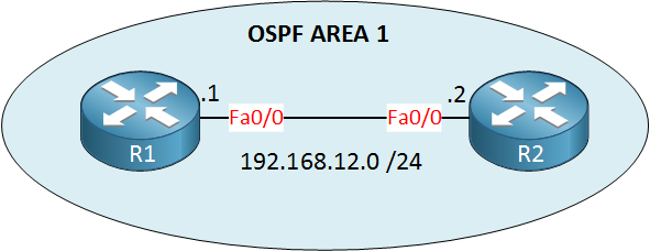

Let’s start with our first scenario. We have two OSPF routers:
R1 R2 OSPF Area 0
Unfortunately they don’t become neighbors:

Here’s a slightly different scenario. Same two routers but this time we use area 1:
ospf r1 r2 area 1 stub
Let’s take a look:
R1#show ip ospf neighbor
R2#show ip ospf neighbor
What a surprise…no neighbors! Let’s dive into the debug:
R1#debug ip ospf hello
OSPF hello events debugging is on
OSPF: Rcv hello from 192.168.12.2 area 1 from FastEthernet0/0 192.168.12.2
OSPF: Hello from 192.168.12.2 with mismatched Stub/Transit area option bits
Hmm interesting. There is a mismatch in the stub/transit area option. OSPF has different area types and both routes have to agree on the area type (stub, nssa, totally stub and totally nssa). Let’s see how they are configured:
R1#show ip protocols | include area
  Number of areas in this router is 1. 1 normal 0 stub 0 nssa
    192.168.12.0 0.0.0.255 area 1
R1 seems to be configured to use a normal area. What about R2?
R2#show ip protocols | include area
  Number of areas in this router is 1. 0 normal 1 stub 0 nssa
R2 seems to be configured to use a stub area. A mismatch in the area type means we can’t establish an OSPF neighbor adjacency. Here’s the OSPF configuration of R2:
R2#show running-config | section ospf
router ospf 1
 log-adjacency-changes
 area 1 stub
 network 192.168.12.0 0.0.0.255 area 1
 permit ospf any any
Here you can see that R2 has the area 1 stub command, let’s get rid of it:
R2(config)#router ospf 1
R2(config-router)#no area 1 stub
We’ll change area 1 into a normal area for R2.
R1# %OSPF-5-ADJCHG: Process 1, Nbr 192.168.12.2 on FastEthernet0/0 from LOADING to FULL, Loading Done
R2# %OSPF-5-ADJCHG: Process 1, Nbr 192.168.12.1 on FastEthernet0/0 from LOADING to FULL, Loading Done
R1 and R2 live happily ever after…
Lesson learned: Make sure your OSPF routers use the same area type.

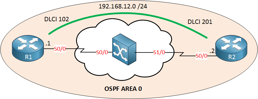

Network Type
Here’s a different topology for you:
ospf r1 r2 frame relay
We have 2 routers connected to each other running frame-relay. For some reason OSPF isn’t establishing the neighbor adjacency.
Here’s the relevant OSPF configuration:
R1#show run | section ospf
router ospf 1
 network 192.168.12.0 0.0.0.255 area 0
R2#show run | section ospf
router ospf 1
It’s just a basic OSPF configuration and you can see that the network commands looks fine. There are no neighbors though:
Let’s see if we have connectivity:
R1#ping 192.168.12.2
Success rate is 100 percent (5/5), round-trip min/avg/max = 4/10/36 ms
I can ping the other side without issues. What about multicast traffic?
R1#ping 224.0.0.5
Sending 1, 100-byte ICMP Echos to 224.0.0.5, timeout is 2 seconds:
Reply to request 0 from 192.168.12.2, 8 ms
I’m also able to ping the OSPF multicast address. This proves that broadcast capabilities for frame-relay have been enabled. I can verify this by looking at the frame-relay maps:
R1#show frame-relay map
Serial0/0 (up): ip 192.168.12.2 dlci 102(0x66,0x1860), dynamic,
              broadcast,, status defined, active
R2#show frame-relay map
Serial0/0 (up): ip 192.168.12.1 dlci 201(0xC9,0x3090), dynamic,
The keyword broadcast means we can send broadcast and multicast traffic down the PVC.
OSPF has different network types:
What OSPF network type is default for a frame-relay interface? Take a look below:
R1#show ip ospf interface serial 0/0 | include Network Type
  Process ID 1, Router ID 192.168.12.1, Network Type NON_BROADCAST, Cost: 64
R2#show ip ospf interface serial 0/0 | include Network Type
  Process ID 1, Router ID 192.168.12.2, Network Type NON_BROADCAST, Cost: 64
Here’s food for thought. The default network type is Non-Broadcast. This means OSPF expects us to configure the neighbors ourselves! Let’s do it:
R1(config)#router ospf 1
R1(config-router)#neighbor 192.168.12.2
R2(config-router)#neighbor 192.168.12.1
I’ll configure the neighbors myself. That should be it:
