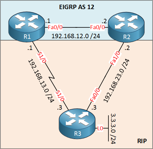

EIGRP Redistribution Sub-Optimal Routing
Here’s a totally different scenario for you:
R1 R2 R3 EIGRP RIP Redistribution Troubleshooting
In the picture above R1 and R2 are running EIGRP AS 12. All routers are running RIP. R3 has a loopback interface with network 3.3.3.0 /24 that will be advertised in RIP. R2 is going to redistribute this network into EIGRP AS 12.
Here are the EIGRP and RIP configurations of all routers:
R1#
router eigrp 12
 network 192.168.12.0
 no auto-summary
router rip
 version 2
 network 192.168.13.0
 no auto-summary
R2#
router eigrp 12
 redistribute rip metric 1 1 1 1 1500
 no auto-summary
router rip
 version 2
 redistribute eigrp 12 metric 5
 network 192.168.23.0
 no auto-summary
R3#
 router rip
 version 2
 network 3.0.0.0
 no auto-summary
Note that R2 has been configured for redistribution between EIGRP AS 12 and RIP. How does this influence our routing selections? Let’s take a look:
R1#show ip route 3.3.3.0
Routing entry for 3.3.3.0/24
  Known via "rip", distance 120, metric 1
  Redistributing via rip
  Last update from 192.168.13.3 on Serial1/0, 00:00:06 ago
  Routing Descriptor Blocks:
  * 192.168.13.3, from 192.168.13.3, 00:00:06 ago, via Serial1/0
      Route metric is 1, traffic share count is 1
R1 is sending traffic towards network 3.3.3.0 /24 using the serial link between R1 and R3. It would have been better if we would use the link between R1 and R2 because using the FastEthernet links is faster than the serial link. Take a look below:
R1#show ip eigrp topology 3.3.3.0 255.255.255.0
IP-EIGRP (AS 12): Topology entry for 3.3.3.0/24
  State is Passive, Query origin flag is 1, 0 Successor(s), FD is 4294967295
  192.168.12.2 (FastEthernet0/0), from 192.168.12.2, Send flag is 0x0
      Composite metric is (2560002816/2560000256), Route is External
We can look at the EIGRP topology table and see that R1 did learn about network 3.3.3.0 /24 through EIGRP from R2. So why are not we using this information instead of RIP?
The problem here is that EIGRP external routes has an AD (administrative distance) of 170 while RIP has an AD of 120.
We can fix this problem by changing the AD:
R1(config)#router rip
R1(config-router)#distance 175 192.168.13.3 0.0.0.0
In the example above I’m setting the AD to 175 for all RIP routes that we learn from IP address 192.168.13.3 (R3). Now check the routing table of R1 again:
  Known via "eigrp 12", distance 170, metric 2560002816, type external
  Redistributing via eigrp 12
  Last update from 192.168.12.2 on FastEthernet0/0, 00:17:53 ago
R1#show ip route | include 3.3.3.0
D EX    3.3.3.0 [170/2560002816] via 192.168.12.2, 00:18:46, FastEthernet0/0
Since the AD of EIGRP external (170) is lower than the AD of my RIP routes (175) R1 will install the EIGRP external information. We are now using the FastEthernet links to get to network 3.3.3.0 /24…problem solved!
Lesson learned: Change the administrative distance to change traffic patterns but be aware; In more complex topologies this can also cause routing loops.

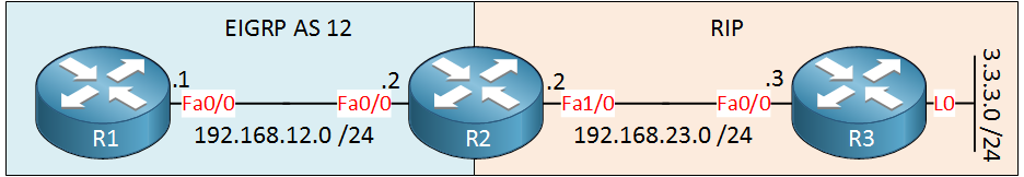

EIGRP Redistribution Seed Metric
Here’s another redistribution issue for you, we have a different topology:
r1-r2-r3-eigrp-rip-redistribution-troubleshooting2
I have another redistribution situation for you. There are 3 routers and R2 is the router performing the redistribution between EIGRP AS 12 and RIP. Here are the configurations:
