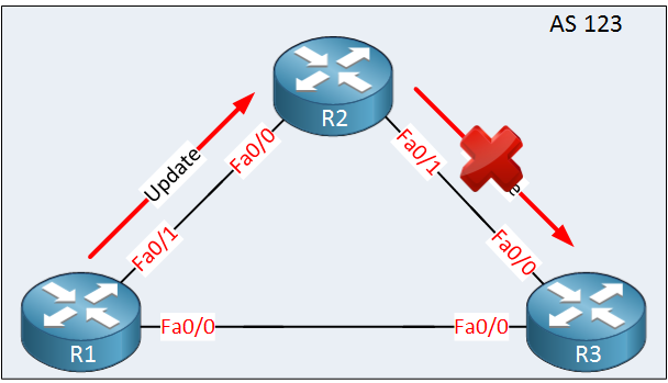

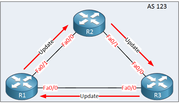

  • IBGP split horizon means that prefixes learned from one IBGP neighbor are not advertised to another IBGP neighbor.
  • IBGP requires a full mesh, meaning all IBGP routers must peer with each other.

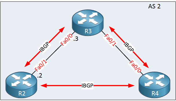

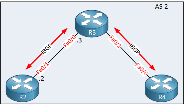

This is why you need IBGP on all your routers in your transit AS. We need to configure IBGP on R3, so it learns about our 1.1.1.0 /24 prefix and will know how to reach the destination.
Just like R2 and R4, I’ll use a loopback interface on R3 as the source of our IBGP session.
I will configure IBGP between R2/R3 and R3/R4.  Let’s create a loopback, advertise it in OSPF, and configure BGP:
R3(config)#interface loopback 0
R3(config-if)#ip address 3.3.3.3 255.255.255.0
R3(config)#router ospf 1
R3(config-router)#network 3.3.3.0 0.0.0.255 area 0
R3(config)#router bgp 2
R3(config-router)#neighbor 2.2.2.2 remote-as 2
R3(config-router)#neighbor 2.2.2.2 update-source loopback 0
R3(config-router)#neighbor 4.4.4.4 remote-as 2
R3(config-router)#neighbor 4.4.4.4 update-source loopback 0
That takes care of R3, now we’ll configure R2 and R4 to peer with R3:
R2(config)#router bgp 2
R2(config-router)#neighbor 3.3.3.3 remote-as 2
R2(config-router)#neighbor 3.3.3.3 update-source loopback 0
R2(config-router)#neighbor 3.3.3.3 next-hop-self
R4(config)#router bgp 2
R4(config-router)#neighbor 3.3.3.3 remote-as 2
R4(config-router)#neighbor 3.3.3.3 update-source loopback 0
R4(config-router)#neighbor 3.3.3.3 next-hop-self
This will establish IBGP between R2/R3 and R3/R4. Take a look at the BGP table of R3:

Right now, our routers within AS2 are configured like this:
Full mesh IBGP between R2, R3 and R4 in AS 2
This is called full-mesh IBGP. All routers within AS 2 are neighbors with each other. Do we really need the IBGP peering between R2 and R4? Let’s find out what happens when I remove it…
R2(config-router)#no neighbor 4.4.4.4
R4(config-router)#no neighbor 2.2.2.2
To visualize it, our picture now looks like this:
IBGP between R2 and R3 and between R3 and R4, no peering between R2 and R4
Let’s check out the BGP table of R3 to see what it has:
R3#show ip bgp
BGP table version is 3, local router ID is 3.3.3.3
              r RIB-failure, S Stale
*>i1.1.1.0/24       2.2.2.2                  0    100      0 1 i
*>i192.168.45.0     4.4.4.4                  0    100      0 3 i
R3 learned about 1.1.1.0 /24 from R2 and 192.168.45.0 /24 from R4. This is good. These are prefixes that we advertised before. Now look at R2:
R2#show ip bgp
BGP table version is 4, local router ID is 2.2.2.2
*> 1.1.1.0/24       192.168.12.1             0             0 1 i
R2 only knows about 1.1.1.0 /24, it didn’t learn about 192.168.45.0 /24 from R3. What about R4?
R4#show ip bgp
BGP table version is 5, local router ID is 4.4.4.4
r> 192.168.45.0     192.168.45.5             0             0 3 i
R4 only learned about 192.168.45.0 /24 from R5, we don’t see 1.1.1.0 /24 here.
The problem is that IBGP does not advertise prefixes from one IBGP neighbor to another IBGP neighbor. This is called BGP split horizon.
There is a good reason why IBGP works like this…
Between different ASes, BGP uses the AS_PATH attribute to avoid routing loops. A prefix will not be accepted by a BGP router if it sees its own AS number in it…plain and simple. However, within the autonomous system, the AS number does not change, so we can’t use this loop prevention mechanism.
Without BGP split horizon, a route could be advertised like this:
