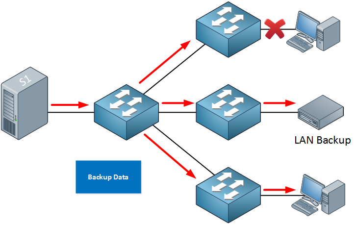

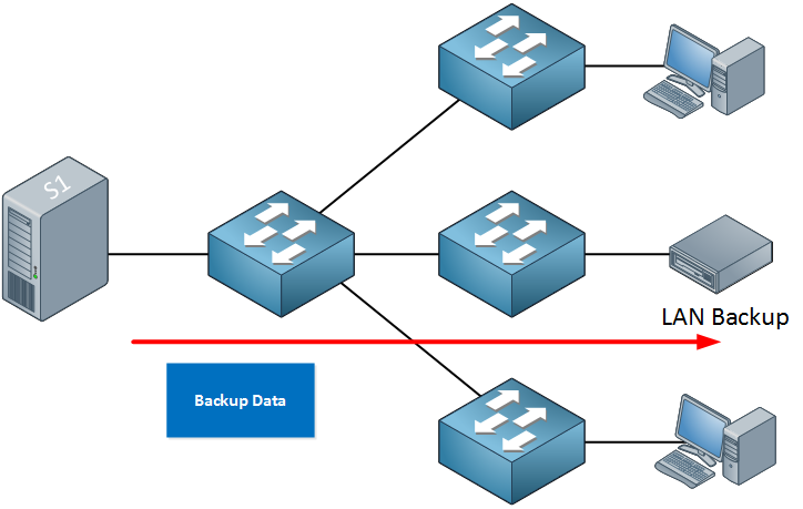

What kind of issues could this cause? Imagine we have a network with a LOT of hosts. Each time an interface goes up or down, a topology change notification will be generated, and ALL switches will set their aging time to 15 seconds. A host will trigger a topology change, and if you have a lot of hosts, you may end up with a network in a constant state of “topology changes”.
Here’s a situation that could occur:
you’re strong man
There is something that i not understand . I worked with network with many hosts , but I didn’t set these in portfast . However there wasn’t problem like you mentioned (burned traffic) , why ?
Hi Alberto,
It’s a good practice to disable TCN generation for interfaces that are connected to hosts. An interface that connects to a host/server doesn’t change the STP topology so there’s no reason to generate TCNs when these interfaces go down. It’s possible that you never encountered the downside of not enabling portfast but an example like the problem with the backup server is possible.
Little confused towards the end, if portfast is enabled on host end and when host interface goes down how does the mac address get cleared on the switches since the tcn is not sent on portfast ports? after the default 5min age time?
Hi Atif,
TCNs are only for spanning-tree. When an interface goes down on the switch, it will clear the MAC addresses associated with it.
