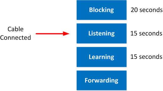

Let’s continue our spanning tree story and further enhance your knowledge. If you have played with some Cisco switches before, you might have noticed that every time you plugged in a cable, the led above the interface was orange and after a while became green. What is happening at this moment is that spanning tree is determining the state of the interface; this is what happens as soon as you plug in a cable:
- The port is in listening mode for 15 seconds. In this phase, it will receive and send BPDUs, still, neither learning MAC addresses nor data transmission.
- The port is in learning mode for 15 seconds. We are still sending and receiving BPDUs, but now the switch will also learn MAC addresses. Still no data transmission, though.
- Now we go in forwarding mode, and finally, we can start transmitting data!
Here’s a picture to visualize it:

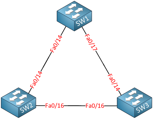

Now you have an idea what spanning tree is about. Let’s take a look at some Cisco switches to see how we can configure them. I will use the same topology that I showed you earlier, but we have different interfaces.
This is the topology we will use. Spanning tree is enabled by default; let’s start by checking some show commands.
SW1#show spanning-tree VLAN0001 Spanning tree enabled protocol ieee Root ID Priority 32769 Address 000f.34ca.1000 Cost 19 Port 19 (FastEthernet0/17) Hello Time 2 sec Max Age 20 sec Forward Delay 15 sec Bridge ID Priority 32769 (priority 32768 sys-id-ext 1) Address 0011.bb0b.3600 Hello Time 2 sec Max Age 20 sec Forward Delay 15 sec Aging Time 300 Interface Role Sts Cost Prio.Nbr Type ------------------- ---- --- --------- -------- -------------------------------- Fa0/14 Desg FWD 19 128.16 P2p Fa0/17 Root FWD 19 128.19 P2p
The show spanning-tree command is the most important show command to remember. There’s quite some stuff here so I’m going to break it down for you!
VLAN0001
We are looking at the spanning tree information for VLAN 1. Spanning tree has multiple versions and the default version on Cisco switches is PVST (Per VLAN spanning tree). This is the spanning tree for VLAN 1
Cost 19
Here you see the information of the root bridge. You can see that it has a priority of 32769 and its MAC address is 000f.34ca.1000. From the perspective of SW1 it has a cost of 19 to reach the root bridge. The port that leads to the root bridge is called the root port and for SW1 this is fa0/17.
This part shows us the information about the local switch, SW1 in our case. There’s something funny about the priority here….you can see it shows two things:
- Priority 32769
- Priority 32768 sys-id-ext 1
The sys-id-ext value that you see is the VLAN number. The priority is 32768, but spanning tree will add the VLAN number, so we end up with a priority value of 32769. Last but not least, we can see the MAC address of SW1, which is 0011.bb0b.3600.
Here’s some information on the different times that spanning tree uses:
- Hello time: every 2 seconds, a BPDU is sent.
- Max Age: If we don’t receive BPDUs for 20 seconds, we know something has changed in the network, and we need to re-check the topology.
- Forward Delay: This timer is used for the listening and learning states. We remain in each state for the duration of the forward delay, which is 15 seconds by default.
The last part of the show spanning tree commands show us the interfaces and their status. SW1 has two interfaces:
• Fa0/14 is a designated port and in (FWD) forwarding mode.
• Fa0/17 is a root port and in (FWD) forwarding mode.
The prio.nbr you see here is the port priority that I explained earlier. We’ll play with this in a bit.
Because only non-root switches have a root port I can conclude that SW1 is a non-root switch. I know that fa0/17 on SW1 leads to the root bridge.
Let’s take a look at SW2 to see what we find:
SW2#show spanning-tree
VLAN0001
Cost 19
Port 18 (FastEthernet0/16)
Address 0019.569d.5700
Aging Time 300
Fa0/14 Altn BLK 19 128.16 P2p
Fa0/16 Root FWD 19 128.18 P2p
What do we see here?
Root ID Priority 32769 Address 000f.34ca.1000 Cost 19 Port 18 (FastEthernet0/16)
Here we see information about the root bridge. This information is similar to what we saw on SW1. The root port for SW2 seems to be fa0/16.
Bridge ID Priority 32769 (priority 32768 sys-id-ext 1) Address 0019.569d.5700
This is the information about SW2. The priority is the same as on SW1. Only the MAC address (0019.569d.5700) is different.
Interface Role Sts Cost Prio.Nbr Type ------------------- ---- --- --------- -------- -------------------------------- Fa0/14 Altn BLK 19 128.16 P2p Fa0/16 Root FWD 19 128.18 P2p
This part looks interesting; there are two things we see here:
• Interface fa0/14 is an alternate port and in (BLK) blocking mode.
• Interface fa0/16 is a root port and in (FWD) forwarding mode.
Last but not least, let’s check SW3:
SW3#show spanning-tree
VLAN0001
This bridge is the root
Aging Time 300
Fa0/14 Desg FWD 19 128.14 P2p
Fa0/16 Desg FWD 19 128.16 P2p
Let’s break down what we have here:
