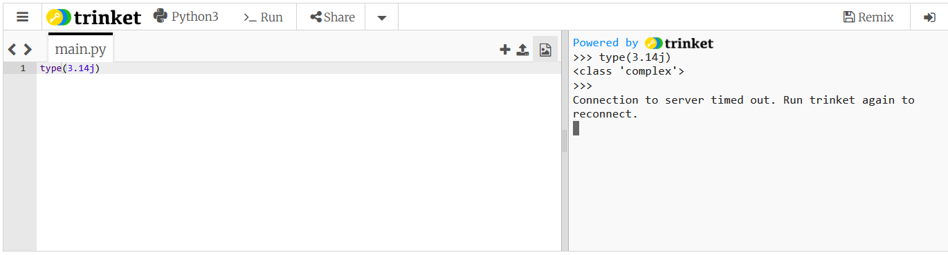

Complex
A complex number is a combination of a real number and an imaginary number. Complex numbers are used in scientific, geometry, or calculus calculations. I never needed these in any of my scripts but for the sake of completeness, I’ll briefly mention them. Here’s an example in Python:
>>> type(3.14j)
Will result in this output:
<class 'complex'>
