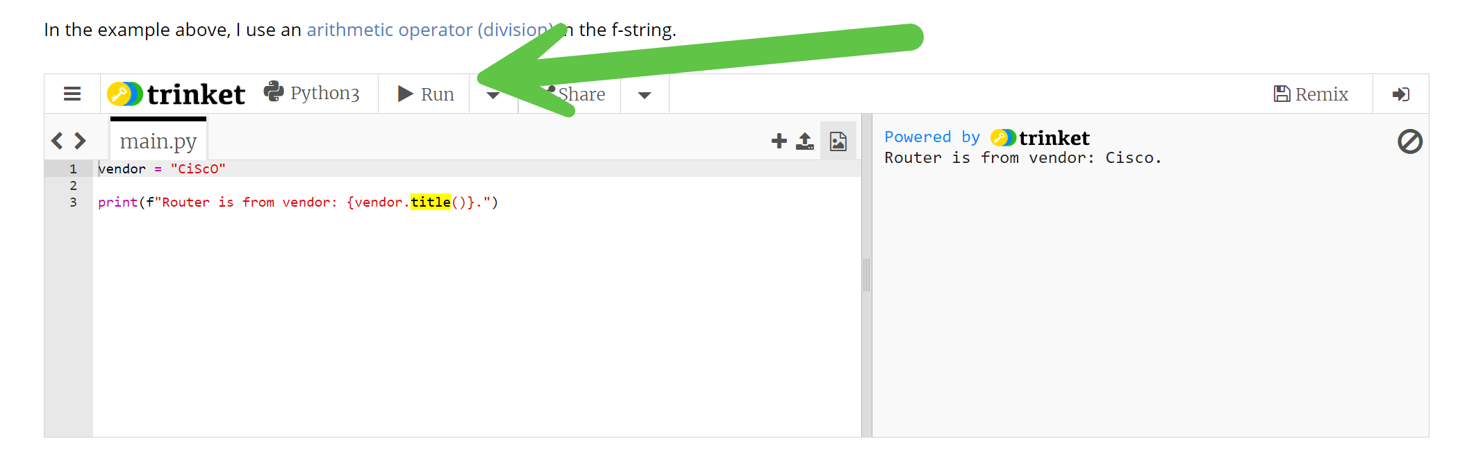

    but why don’t you show the print output in the lessons ?
    We use https://trinket.io for lessons so it’s interactive:
    https://forum.networklessons.c...07d1221fed7e8fc15
    For local testing, it’s best to use vscode.
    Hello Ahmedlmad
    Using the Trinket applet, you can see the output in the pane on the right in the lessons. For the particular code you mentioned, I get this:
    https://forum.networklessons.c...e000036cf345ed331

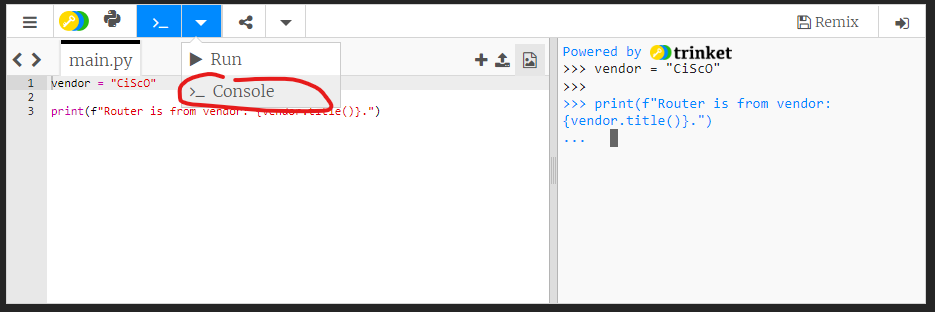

    You can see the output on the right. You can also display the console output by clicking the “Console” option as shown below:
    https://forum.networklessons.c...1bed468b1343cee9e
    Does that make sense?
