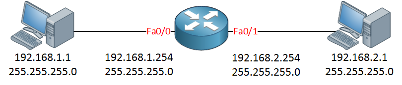

Now let’s take a look at an example where we do require a default gateway. Take a look at this picture:
two hosts two subnets router in between
Above we have two hosts and two networks:
  • 192.168.1.0
  • 192.168.2.0
In between is a router that has two interfaces, it has an IP address for each network. The host on the left side will use 192.168.1.254 as its default gateway and the host on the right side will use 192.168.2.254 as its default gateway.
