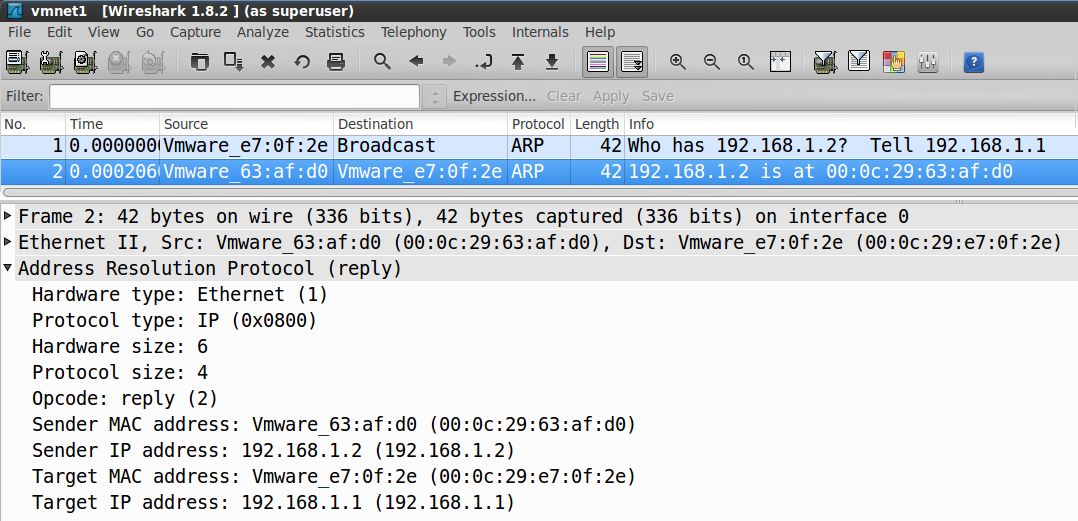

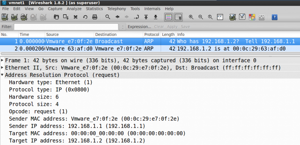

If you want to see this in action you can look at it in Wireshark:
ARP in Wireshark
Above you see the ARP request for H1 that is looking for the IP address of H2. The source MAC address is the MAC address of H1, the destination MAC address is “Broadcast” so it will be flooded on the network.
The second packet is the ARP reply. H2 will send its MAC address to H1. Here’s a detailed look at each packet. We’ll start with the ARP request:
Frame 1: 42 bytes on wire (336 bits), 42 bytes captured (336 bits) on interface 0
Ethernet II, Src: Vmware_e7:0f:2e (00:0c:29:e7:0f:2e), Dst: Broadcast (ff:ff:ff:ff:ff:ff)
Address Resolution Protocol (request)
Hardware type: Ethernet (1)
Protocol type: IP (0x0800)
Hardware size: 6
Protocol size: 4
Opcode: request (1)
Sender MAC address: Vmware_e7:0f:2e (00:0c:29:e7:0f:2e)
Sender IP address: 192.168.1.1 (192.168.1.1)
Target MAC address: 00:00:00_00:00:00 (00:00:00:00:00:00)
Target IP address: 192.168.1.2 (192.168.1.2)
In this ARP request, you can see the sender (192.168.1.1) and that it’s looking for the MAC address of target 192.168.1.2. Here is the ARP reply:
Frame 2: 42 bytes on wire (336 bits), 42 bytes captured (336 bits) on interface 0
Ethernet II, Src: Vmware_63:af:d0 (00:0c:29:63:af:d0), Dst: Vmware_e7:0f:2e (00:0c:29:e7:0f:2e)
Address Resolution Protocol (reply)
Hardware size: 6
Protocol size: 4
Opcode: reply (2)
Sender MAC address: Vmware_63:af:d0 (00:0c:29:63:af:d0)
Sender IP address: 192.168.1.2 (192.168.1.2)
Target MAC address: Vmware_e7:0f:2e (00:0c:29:e7:0f:2e)
Target IP address: 192.168.1.1 (192.168.1.1)
You can see that H2 sends its MAC address in the ARP reply to H1. That’s all I wanted to show you about ARP. If you enjoyed this lesson, please leave a comment.

  1. Hello,
    Why in the ARP reply packet do we see 00:00:00:00:00:00 as Target MAC address instead of FF:FF:FF:FF:FF:FF ?
  2. I meant ARP request
  3. FF:FF:FF:FF:FF:FF in binary is all 1s…in other words, it will be broadcasted within the broadcast domain. This way the ARP request reaches all devices in the broadcast domain.
  4. I agree with that. That’s why I wonder why we see 00:00:00:00:00:00 is the ARP request screenshot…
