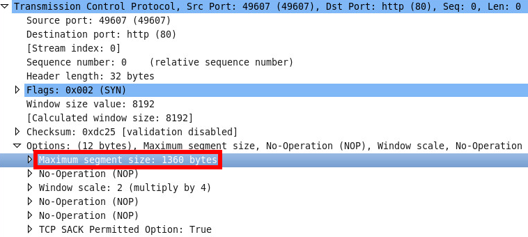

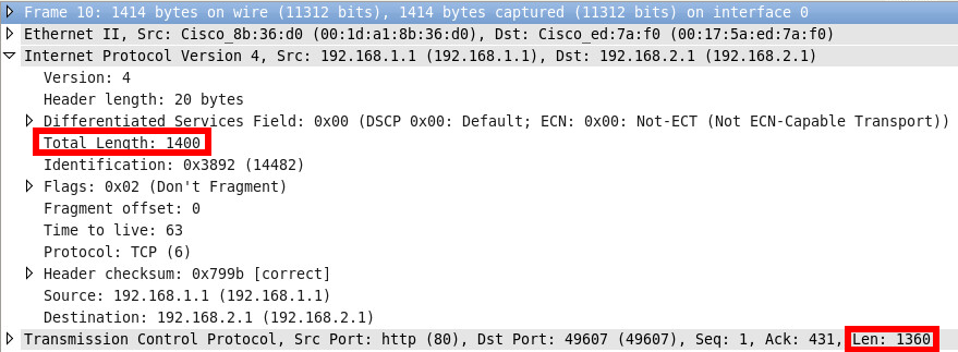

This tells the router to fragment all outgoing IP packets when they exceed 1400 bytes. The second step is to tell the router to intercept all TCP SYN packets from hosts and change the MSS value. We do this on the interface that faces our hosts:
R2(config)#interface fastEthernet 0/1
R2(config-if)#ip tcp adjust-mss 1360
Setting the TCP MSS value to 1360 ensures that our total MTU will be 1400 bytes (1360 + 40). Does this work? Let’s look at a Wireshark example between our host and webserver again:
