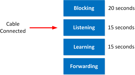

Are you following me so far? Good! You just learned the basics of spanning tree. Let’s add some more detail to this story…
Let’s continue our spanning tree story and further enhance your knowledge. If you have played with some Cisco switches before, you might have noticed that every time you plugged in a cable, the led above the interface was orange and after a while became green. What is happening at this moment is that spanning tree is determining the state of the interface; this is what happens as soon as you plug in a cable:
  • The port is in listening mode for 15 seconds. In this phase, it will receive and send BPDUs, still, neither learning MAC addresses nor data transmission.
  • The port is in learning mode for 15 seconds.  We are still sending and receiving BPDUs, but now the switch will also learn MAC addresses. Still no data transmission, though.
  • Now we go in forwarding mode, and finally, we can start transmitting data!
Here’s a picture to visualize it:
Stp Port States

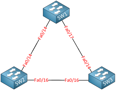

Now you have an idea what spanning tree is about. Let’s take a look at some Cisco switches to see how we can configure them. I will use the same topology that I showed you earlier, but we have different interfaces.
switches in triangle2
This is the topology we will use. Spanning tree is enabled by default; let’s start by checking some show commands.

Because only non-root switches have a root port I can conclude that SW1 is a non-root switch. I know that fa0/17 on SW1 leads to the root bridge.
Let’s take a look at SW2 to see what we find:

What do we see here?
Root ID    Priority    32769
             Address     000f.34ca.1000
             Cost        19
             Port        18 (FastEthernet0/16)
Here we see information about the root bridge. This information is similar to what we saw on SW1. The root port for SW2 seems to be fa0/16.
Bridge ID  Priority    32769  (priority 32768 sys-id-ext 1)
             Address     0019.569d.5700
This is the information about SW2. The priority is the same as on SW1. Only the MAC address (0019.569d.5700) is different.
Interface           Role Sts Cost      Prio.Nbr Type
Fa0/14              Altn BLK 19        128.16   P2p
Fa0/16              Root FWD 19        128.18   P2p
This part looks interesting; there are two things we see here:
• Interface fa0/14 is an alternate port and in (BLK) blocking mode.
• Interface fa0/16 is a root port and in (FWD) forwarding mode.
Last but not least, let’s check SW3:
SW3#show spanning-tree
VLAN0001
  Spanning tree enabled protocol ieee
             This bridge is the root
             Hello Time   2 sec  Max Age 20 sec  Forward Delay 15 sec
             Aging Time 300
Fa0/14           Desg FWD 19        128.14   P2p
Fa0/16           Desg FWD 19        128.16   P2p
Let’s break down what we have here:
