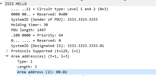

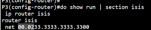

  3. Avatar for davidilles davidilles says:
    I found something weird when labbing and I would like to confirm this. If I configure this NSAP address on one of my XE routers - net 0002.3333.3333.3333.00. It will advertise its Area Address like this:
    I believe the IOS moves the first two zeroes that I have configured into the AFI part (since NET addresses start with XX.XXXX …).
    If I configure this NSAP address on one of my neighboring XR routers - net 0002.4444.4444.4444.00. It will advertise its Area Address like
    This is expected behavior, and it is related to the use of 00 (in hexadecimal) for the AFI. This addressing scheme was designed for a much broader use, rather than just for ISIS. In this sense, the AFI plays an important role, informing routers about who owns the address space and how the rest of the NSAP should be interpreted.
    00 is a reserved/undefined AFI within the ISO standard. It does not point to any public or private authority, nor is it considered a valid numbering plan. So, for the purposes of ISIS, it is a bad practice to use it
