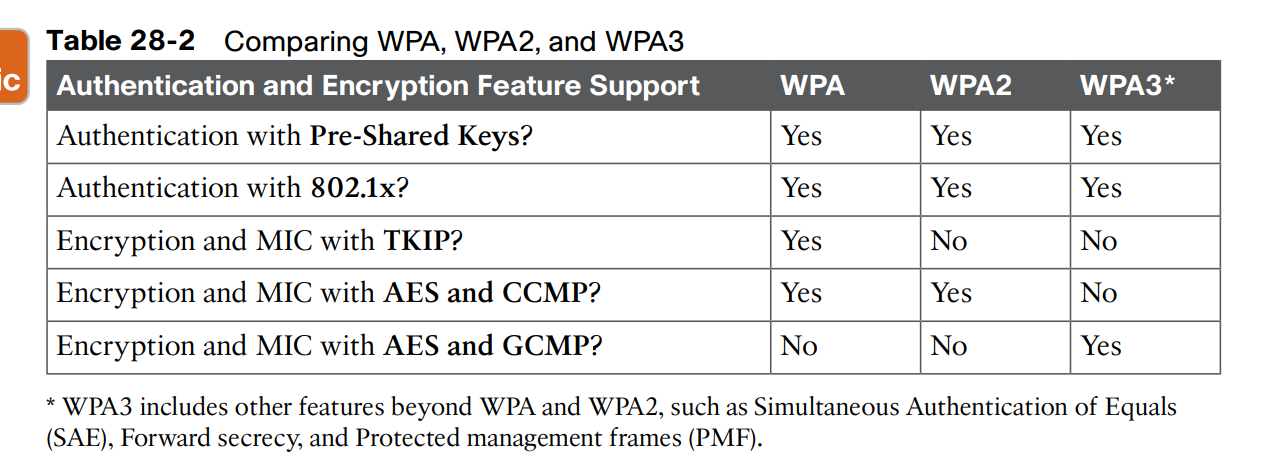

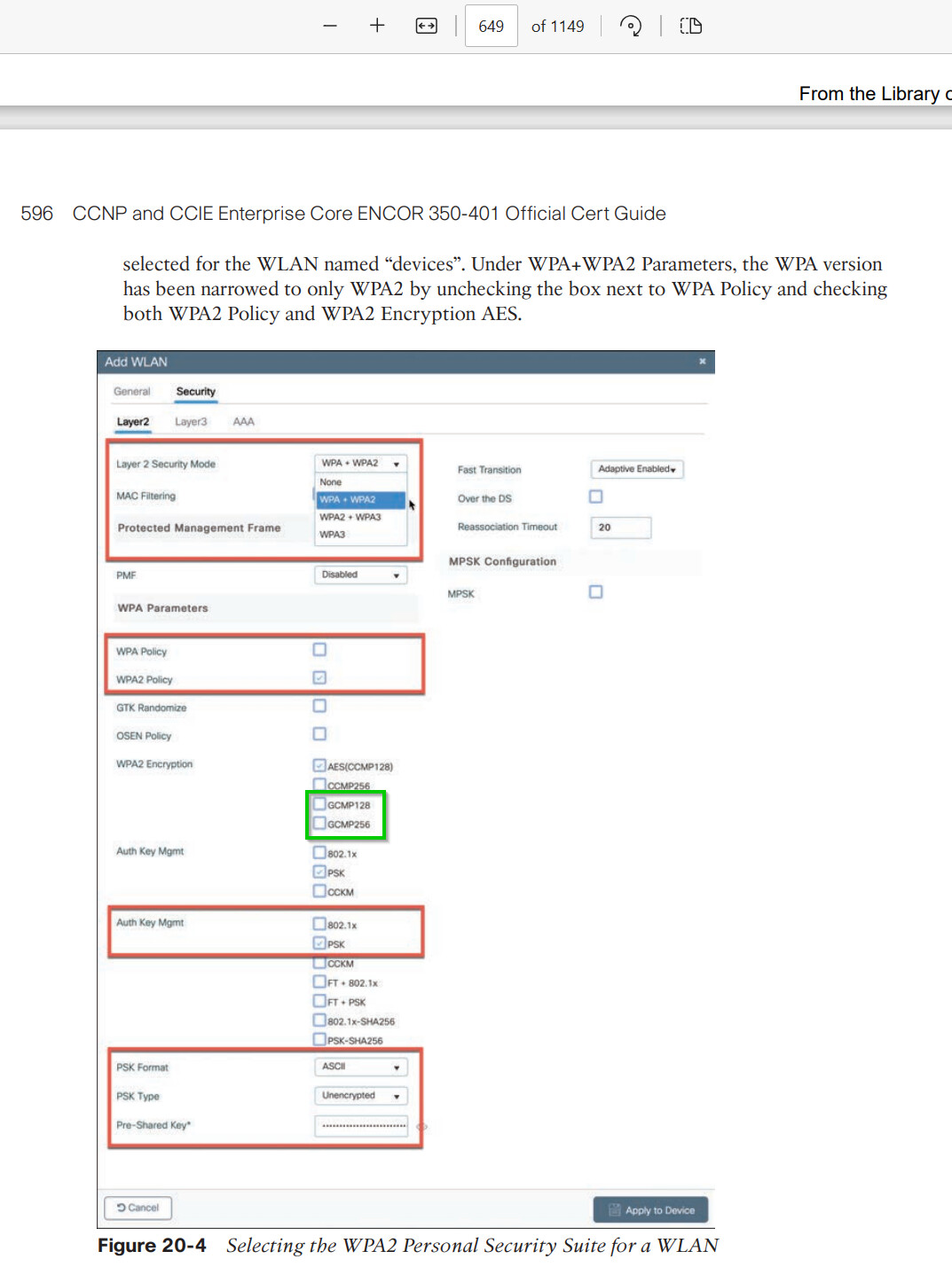

  3. Avatar for molnarattila1221 molnarattila1221 says:
    I’d like to ask for clarification regarding the following question:
    The ENCOR OCG shows the following WLC page (sorry about the grainy image, it’s like that in the book):
    https://forum.networklessons.c...aa6509afb282ad41f
    WPA2 Policy is selected in this example. However, I see that GCMP encryption types can also be selected. What is the reason why this is offered, if only WPA3 can use GCMP, while the other WPA versions can’t?
    This table is from the CCNA OCG:
    https://forum.networklessons.c...a08de951ba3a4c2cd
    Comparing the two images, I can see
    Hello Attila
    Happy New Year to you too!
    molnarattila1221:
    The GCMP encryption option is listed under WPA2 Encryption in the WLC settings because some WPA2 implementations, particularly those used in 802.11ac and 802.11ax (Wi-Fi 5 and Wi-Fi 6) can actually use GCMP. It’s not common, but it is possible, hence its inclusion in the options. However, it’s more commonly used with WPA3, as you’ve
