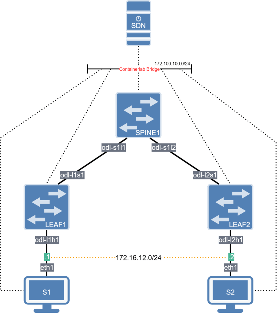

We’ll run this in Containerlab. We’ll create a single topology with the OpenDaylight SDN controller and a number of switches. Everything you need is in the Networklessons Github lab repository. Here is the topology:
SDN controller connected through a Containerlab bridge (172.100.100.0/24) to SPINE1, LEAF1, LEAF2, S1 and S2; S1 and S2 share 172.16.12.0/24 through the leaf switches

This topology defines a network with the SDN controller, a spine switch, two leaf switches, and two hosts. Let’s deploy it:

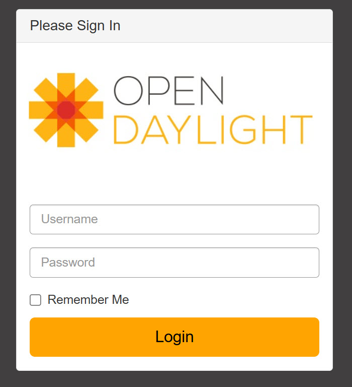

We can now try to access the controller from a browser. Enter the following URL:
http://172.100.100.10:8181/index.html#/login
You will see the following login screen:
Opendaylight Login Screen

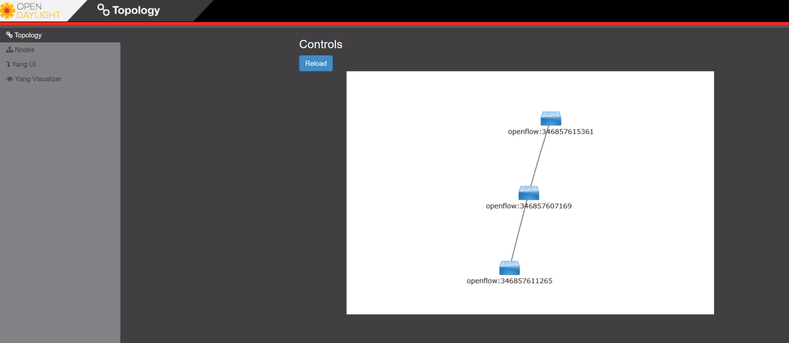

The default username and password are “admin”. Click on login, and you will see the topology screen:
Opendaylight Topology Three Switches
We can see our three switches, which tells us that they are connected to the SDN controller.

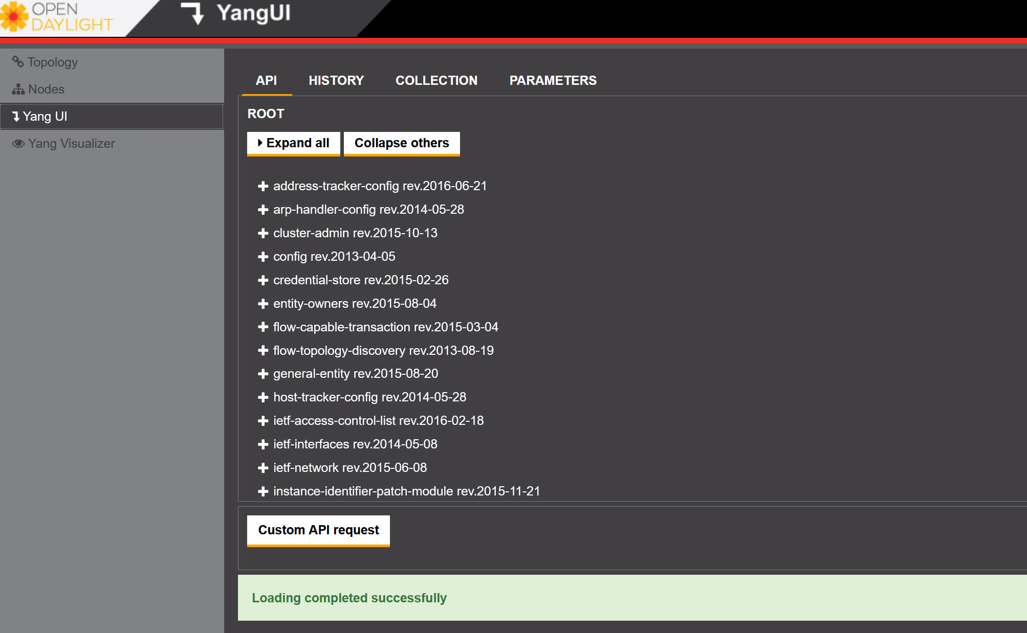

Yang UI
We can access Yang from the OpenDaylight GUI so let’s take a look:
Opendaylight Yang Ui Expand

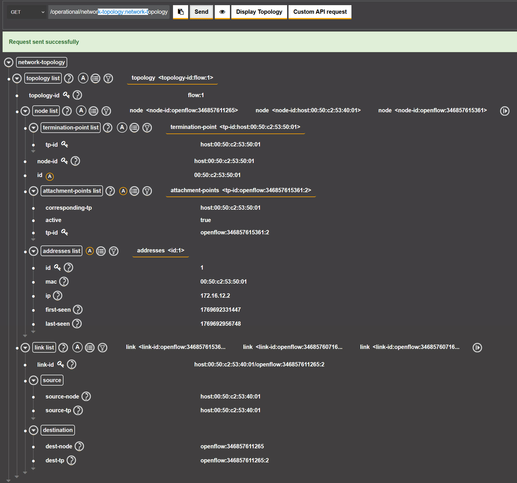

Above you see a lot of different objects. Let’s see if we can fetch the current (operational) network topology through Yang:
opendaylight yang ui network topology
Once you click on the network topology, Yang will automatically show you the RESTCONF API URL that it uses to retrieve this information:
opendaylight yang ui rest api http get
You can copy this URL and paste it in notepad so we can use it later:
opendaylight yang ui clipboard
Here’s the URL that I got:
http://172.100.100.10:8181/restconf/operational/network-topology:network-topology
Click on the Send button:
opendaylight yang ui send
And you will see the operational network topology:
Opendaylight Yang Ui Topology Network
Above you can see the information about our current topology, including the MAC and IP addresses of our hosts.

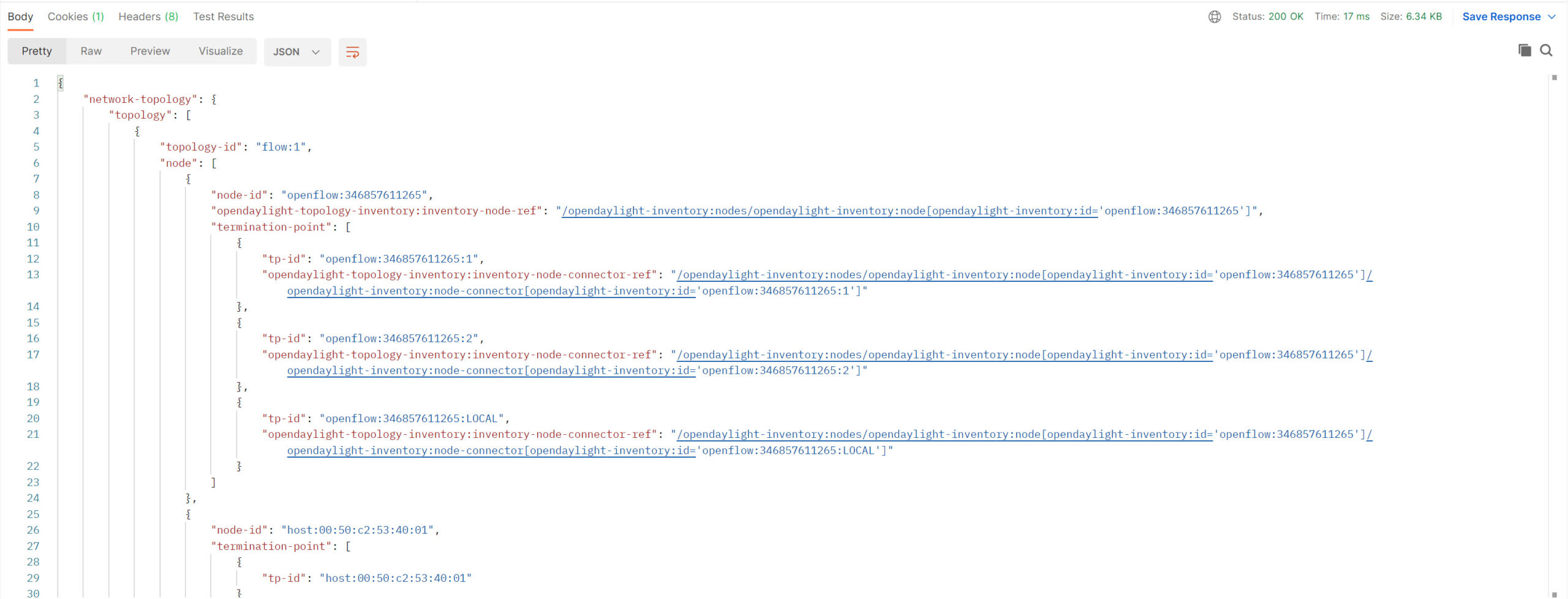

Once you hit the Send button, you will get a response in JSON:
Postman Opendaylight Json Result
Above, you can see the same output as what we saw in Yang UI, but this time, it’s in JSON format. One of the advantages of Postman is that you can save your requests or download collections of requests from others. For example, here’s a collection of OpenDaylight requests provided by CiscoDevNet.
