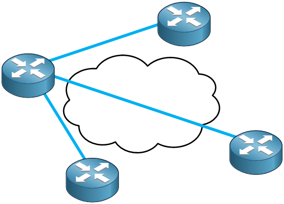

This is a picture of frame relay and it works a bit different. The idea behind frame relay is that you have a single infrastructure from the service provider and multiple customers are connected to it, effectively sharing everything.
In the middle you see a cloud with an icon you probably haven’t seen before. This icon is the frame relay switch. The cloud is called the frame relay cloud and the reason it has this name is because for us as customer it’s unknown what happens in the frame relay cloud. This is the service provider’s infrastructure and we really don’t care what happens there…we are the customer and all we want is connectivity!
What else do you see? There are two customers (1 and 2) and each of them has a Headquarters (Hub) and a branch office (Spoke).

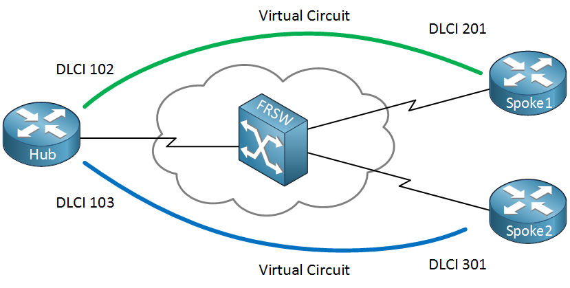

frame relay virtual circuit
We call our service provider since we want connectivity and the first question they’ll ask us is which sites should be connected?. In the example above you can see two virtual circuits, the green and blue one. With frame relay there’s a difference between the physical and logical connections. The physical connection is just the serial cable which is connected to the provider. Our logical links are virtual circuits. As you can see there is a virtual circuit from Spoke1 to the Hub and another one from Spoke2 to the Hub.
This means that we can send traffic through our virtual circuits between:
  • Spoke1 and Hub.
  • Spoke2 and Hub.
There is no virtual circuit between Spoke1 and Spoke2. Does this mean there is no connectivity between them? No you can still have connectivity between them by sending data to the Hub! Of course you can get another virtual circuit between Spoke1 and Spoke2 but you’ll have to pay for it. Virtual circuits are also called PVC (Permanent Virtual Circuit).

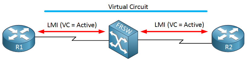

frame relay virtual circuit active lmi
Here’s an example of LMI in action. In the middle we have the frame relay switch. LMI packets are sent between R1 and the frame relay switch and R2 and the frame relay switch. The frame relay switch tells our routers that the PVC is active.

frame relay dlci
For each PVC you will get a DLCI per router. In our example above you can see that for the PVC between the Hub and Spoke1, we have DLCI 102 on the Hub and DLCI 201 on Spoke1.
Between the Hub and Spoke2, we have DLCI 103 on the Hub and DLCI 301 on Spoke2. Our DLCI is nothing more but a unique identifier for the data link layer per PVC.

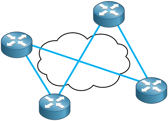

  • Full-mesh
  • Partial-mesh
  • Hub and Spoke
Let me show you an example of each topology type:

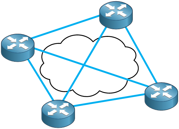

Frame-Relay Full Mesh
This is our full-mesh topology. As you can see there is a PVC between every router.

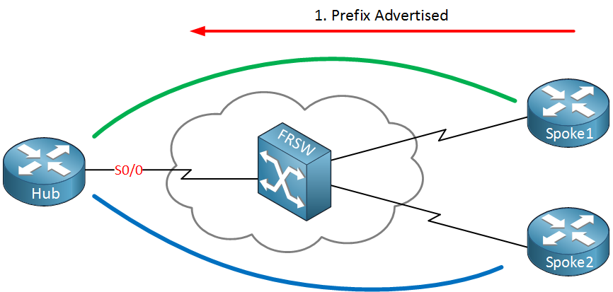

frame relay split horizon prefix advertisement
What other problems might we encounter with frame relay and routing? Do you remember the characteristics of distance vector routing protocols (RIP and EIGRP)?
In the picture above I have configured RIP on all the routers. Spoke1 is sending routing information towards the Hub. If we look at the routing table we see this routing information on the Hub.

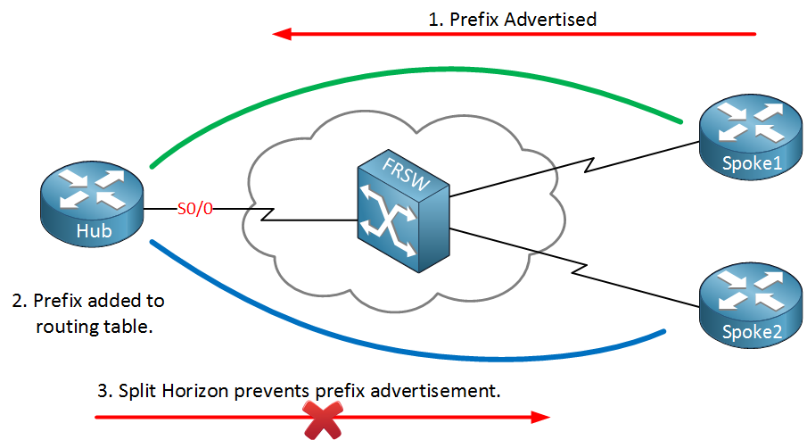

frame relay split horizon prevents advertisement
Do you remember the split-horizon rule? Whatever you learn from your neighbor you don’t advertise back to them. To be more specific: whatever you learn on an interface you don’t advertise it back out on the same interface.
We are using two PVC’s but on the Hub there is still only one physical interface. Split-horizon will prevent the advertisement of routing information towards Spoke2.
How can we solve this problem?
  • You can disable split horizon (the default on physical interfaces).
  • You can use sub-interfaces.

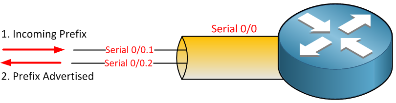

Cisco router Serial Subinterface
If you use a sub-interface you don’t have the split-horizon problem since you are learning routing information on serial0/0.1 and advertising it out of serial0/0.2
Frame-relay can use point-to-point sub-interfaces or point-to-multipoint sub-interfaces. If you use point-to-point it will solve your split-horizon problem but you’ll need to use a different IP subnet per PVC. Point-to-multipoint means you have the split-horizon problem but you can use a single IP subnet for all PVCs.

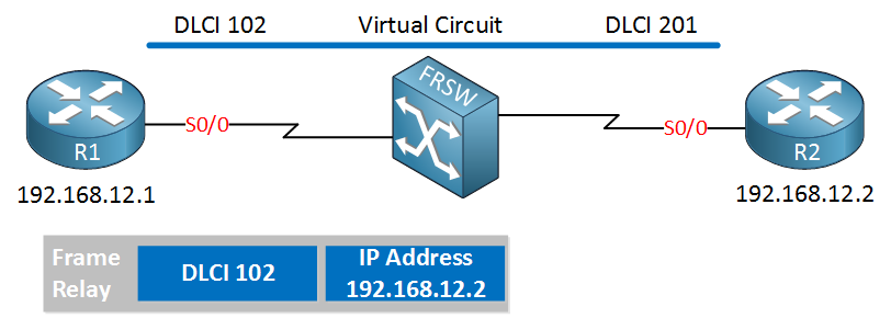

Remember ARP (address resolution protocol)? When we use ARP for Ethernet we need to learn the MAC address of the computer we want to send something to. ARP effectively maps the destination IP address to the destination MAC address.

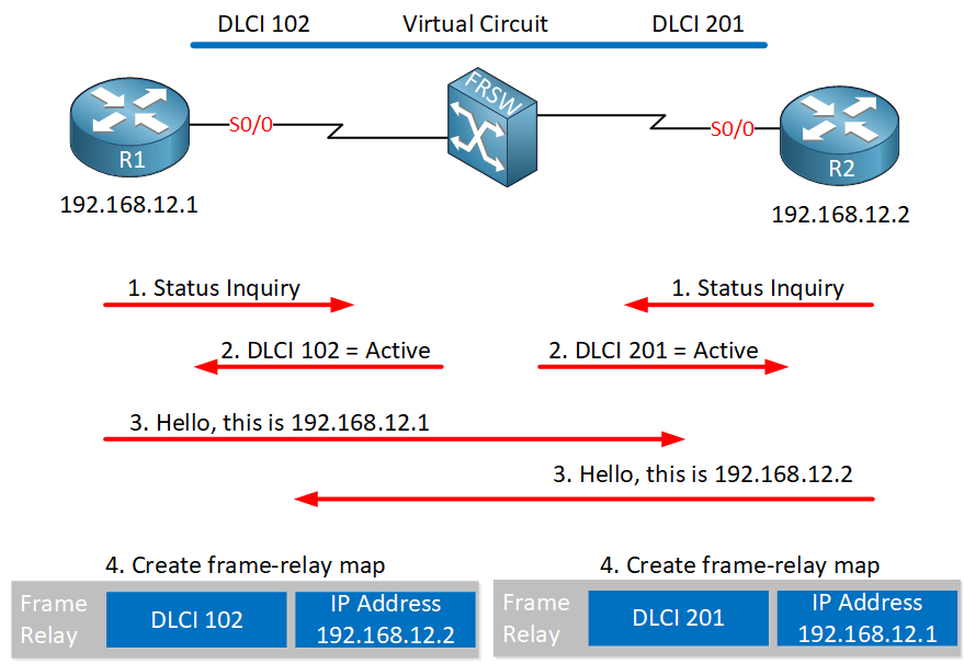

Frame-relay uses inverse ARP and is a bit different. Remember my story about the train platform and how your router only knows it’s local DLCI? You don’t know the DLCI of the other side. Inverse ARP is going to map your local DLCI to the IP address of the other side:
frame relay inverse arp mapping
R1 in my example above has mapped the IP address of R2 (192.16.12.2) to its local DLCI 102. That’s inverse ARP.

    Router Frodo will now know it can reach IP address 192.168.12.1 by sending traffic through the PVC with DLCI 102. Router Gandalf will know that it can reach IP address 192.168.12.1 through the PVC with DLCI 201.
    its should be 192.168.12.2 if i am ri8 by sending traffic through dlci 102
    Hi Anirban,
    You are right, just fixed this error.
